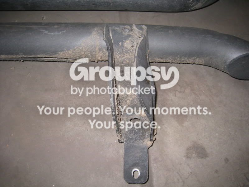

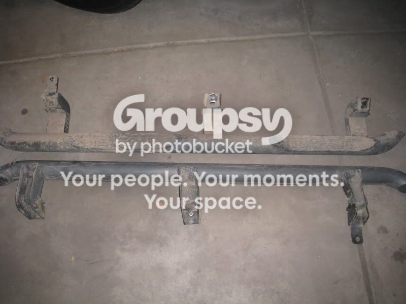

As you probably already know, the stock step tubes are very flimsy and will buckle under even a little pressure on a trail. Below are a couple of pics of the stock step tubes, illustrating how much abuse they took while they were on there.
IMG_6770.jpg~original
IMG_6769.jpg~original

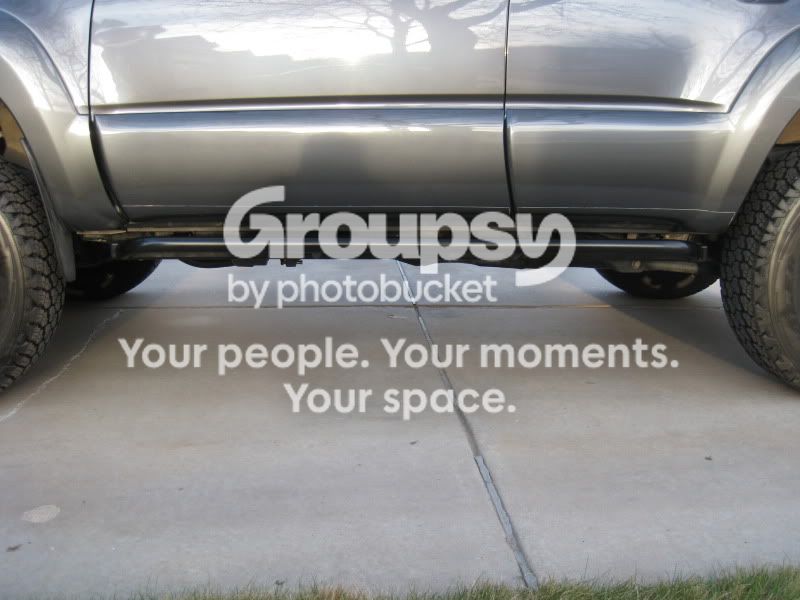

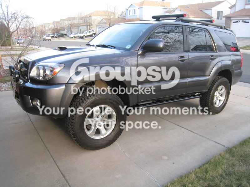

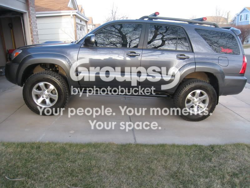

Regardless, we got them on and I am pleased with the end result. I drove my 4Runner around after the install and everything seems to be very tight and I did not hear anything wiggle around. I will get under it again here in the next week or two to re-torque everything once I've put some miles on it, but I don't think these sliders are going anywhere.
IMG_6902.jpg~original
IMG_6907.jpg~original
IMG_6904.jpg~original
I'm happy with the final result, but the true test will be on the trails. From everything I've read, these should hold up great.
