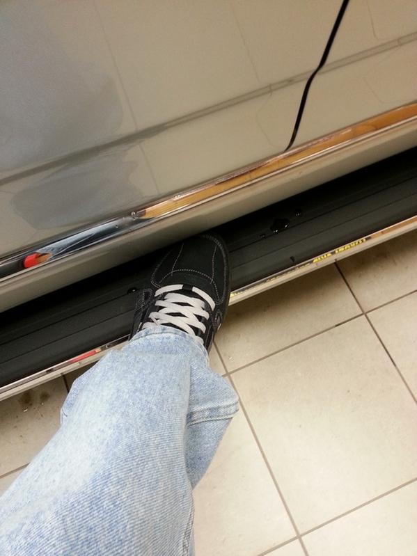

is it possible to get a pic with your foot on the slider? so I can get an idea how much space you gain from this compared to the OEM running boards?
granted this is an LE with the rocker still attached. I know if I get these sliders I would have to remove the rockers which should free up some space/gap to get a better toe hold on the sliders. the OEM setup sucks but needed them to protect the lower doors during winter.
ie :

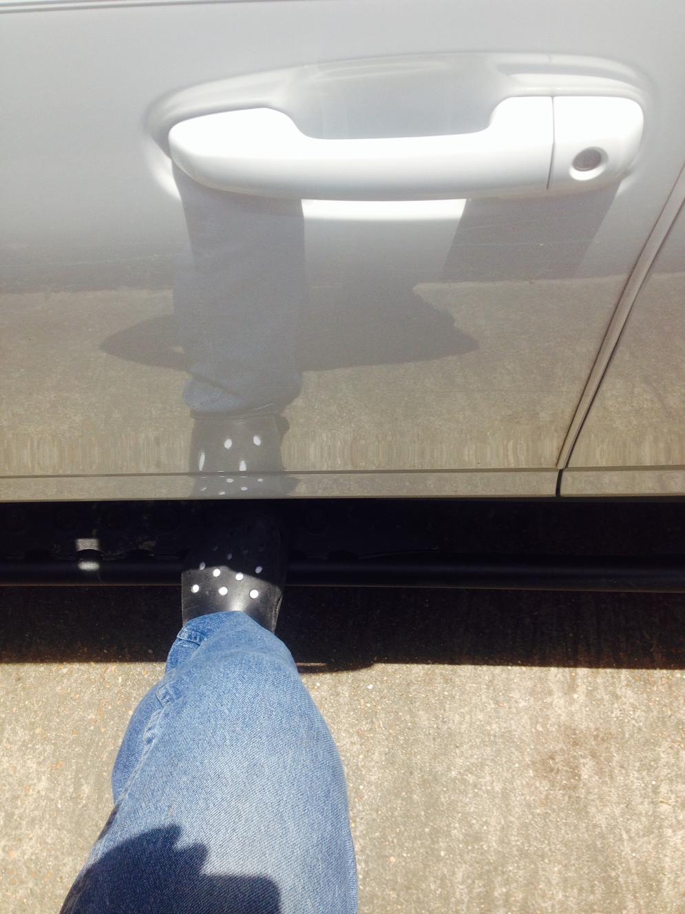

Sorry about the quality. Bright sun directly overhead and OMG White paint do not mix well. I tried to take this looking down the door and including the handle. I wear a size 11 shoe and I can get the ball of my foot on the outer bar with the door closed. Probably more with it open. I don't normally use the steps, even on the Nfabs it used to have. They are there for wife's use. They do extend out wide enough I drag my inner calf muscle on them getting in and out. I hope it's clear enough to be helpful.

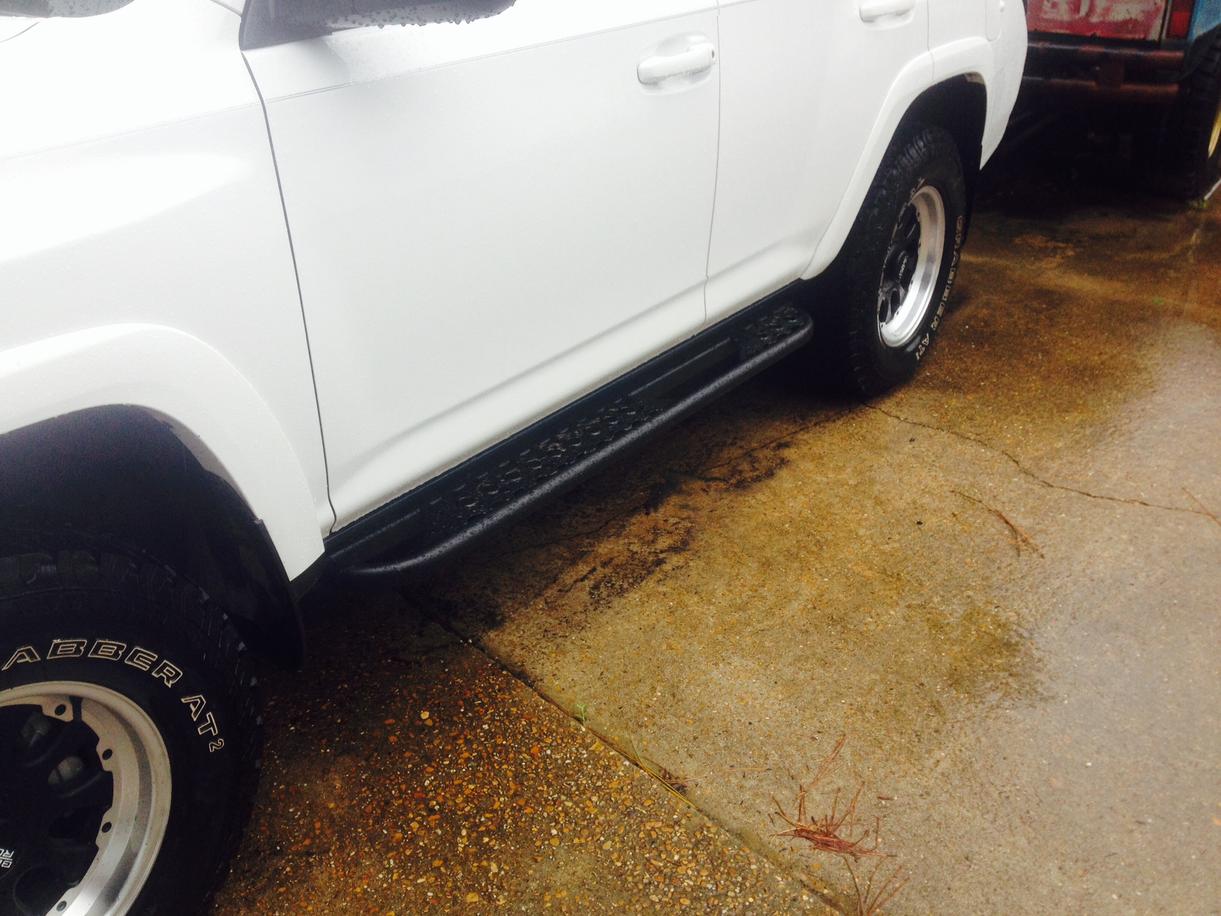

They work awesome. the step is the way to go! Finished them up last night. Ordered 2/10/14 and received 6/5/14. The lowest part of the slider is even with the bottom of the frame rail.

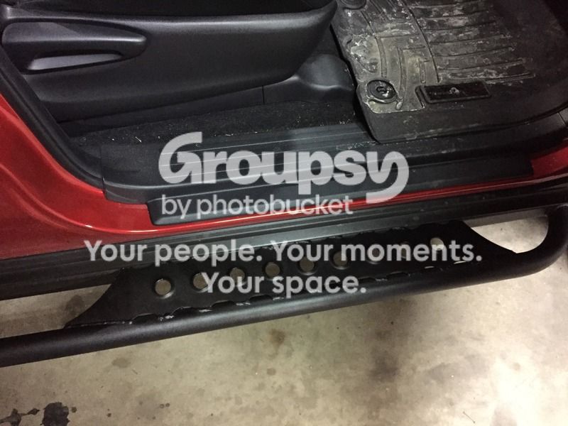

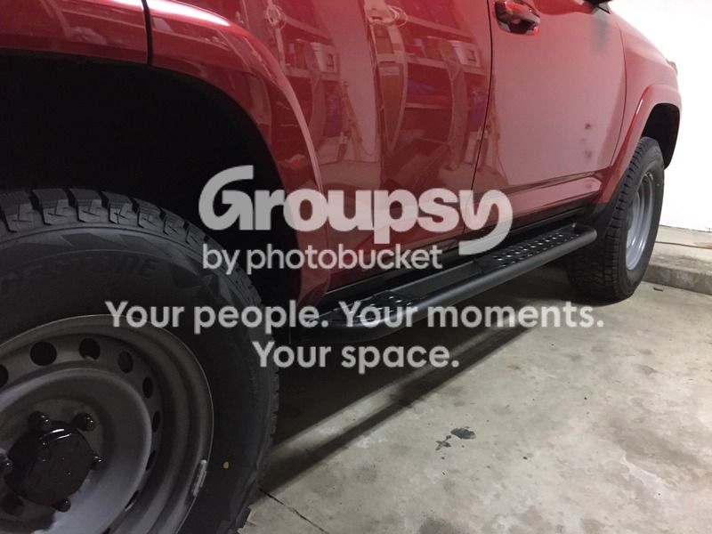

If anyone has purchased the shrockworks sliders with dimpled tread plates and textured powder coat, I'd love to see a picture. Thanks!
