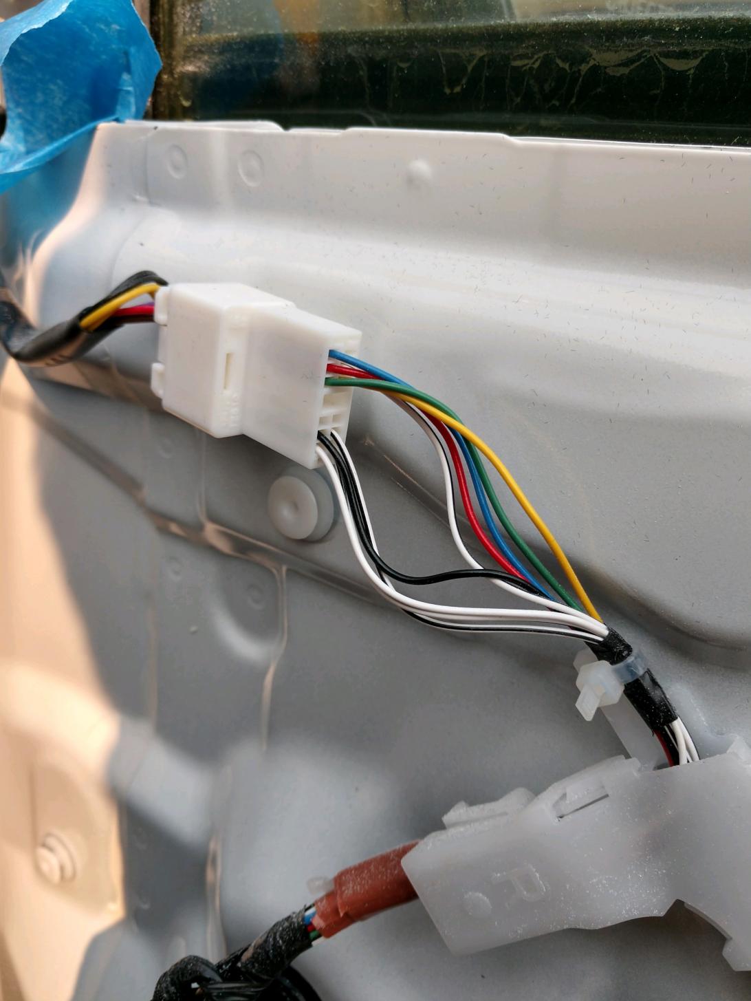

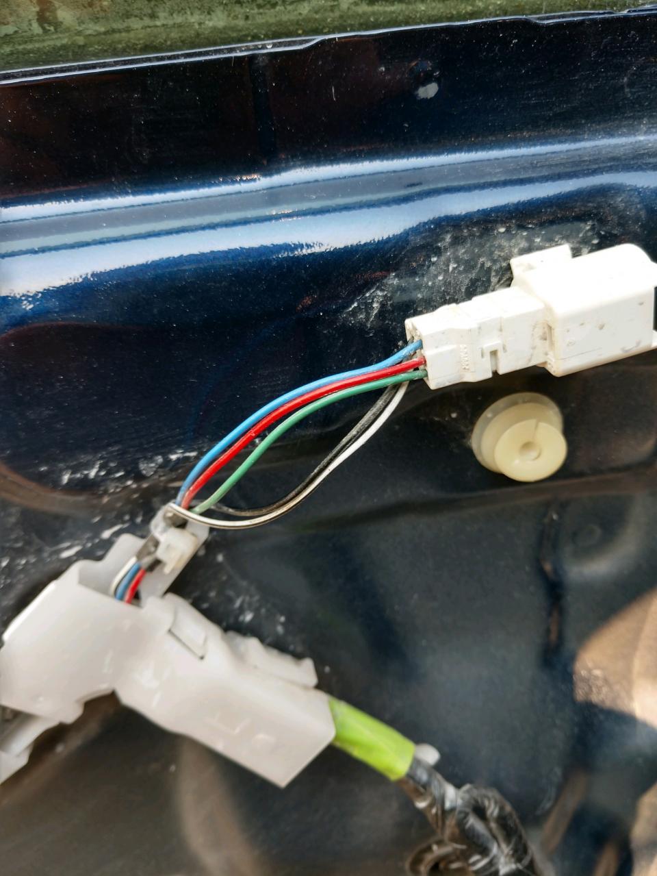

I have an SR5 premium that needed a new door, I replaced the door with what I believe is and SR5 and can confirm the wiring harness is in fact different. I don't have an exact part number, but the new harness itself is $341! If you come across a work around I'de love to hear it. First picture is the harness from the SR5 premium, second is what I believe to be an SR5.

Ultimately, the answer lies somewhere in between yes and no. Yes the mirrors are structurally the exact same and connect the same to the frame of the door.

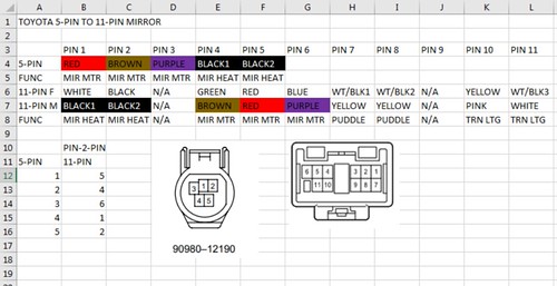

The Non-premium mirror uses a 5-pin connector which only functions the mirror motors and heaters.
The premium mirror uses a 11-pin connector that brings in the connections for the +/- of each puddle and turn signal lamp.
[MENTION=150567]Old Red[/MENTION] is the resident expert on this topic, as he was able to figure out where to land the puddle/turn signal wires within the older style door harness. And is currently developing a harness product that we all hope goes on sale soon.
You can find all the information I have currently figured out in the pin-out diagram below and within the thread link.

Thank-you for the information, the diagram is helpful. I did see that post, and am hoping the harness will be available for purchase soon.
