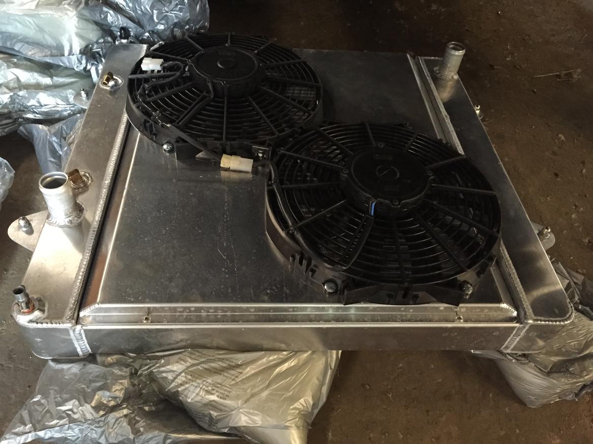

It's made by AFCO Racing Radiators. Another member on here from 4th gens had it built. He installed it in his V-8 4Runner...so on long slow trail rides he wouldn't have to worry about over heating out in the Hot west. He stated between the radiator, electric fans, over flow canister and what-not..IIRC he had a little over $1500-$1600 into it. Had it installed less than 6 months and had to sell his 4Runner, so he took it all out to sell. He had it adversived on here for 8+months for a 4th gen. I saw it and got the dimensions...measured everything and figured I could make it work. I got a hell of a deal on it!!

Do you have any pictures of this set up This sounds interesting...
I only have a couple a can find right now. The 4Runner is over at my buddy's shop...but here's what it looked like when I unpackaged it. Like I said, nice set up. From what he told me, he called them up and told what he wanted it and they built it for him.
Hope this helps you...

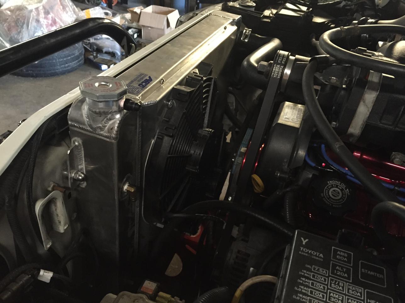

Can you post the dimensions of the radiator.
Height
Length of core
Length of core plus tanks
Length of mounting tab holes
Thanks

Hello Sir, hey my Runner is over at our shop...I'll be glad to get you all these messurements...but it will be a couple days for Im able to get over there. Please be patient with me...and I'll get you hooked up.
Height - 23"
Length of core - 20 1/2"
Length of core plus tanks - 26 1/2"
Length of mounting tab holes - 1"
Thanks
Apologies for taken so long to get back with you. Been very hectic around here as of late. Anyway, I hope this helps. I wish I knew how to add more than one picture at a time, but that's all it will let me do with attachments...when I hit add pictures it ask for a web address, which I don't have.
Anyway...here are some additional messurements: the core is 2 1/2" thick and end tanks are 3"...then add the two e-fans with the alumuin shroud for a total width of 5 3/4".
This radiator is big enough to cool a Chevy big block!! I will easily be able to take my S/C Runner on any slow technical mountainous trail on the hottest day of the year with the A/C on max...and never break 190*.
If you need anything else...please feel free to ask. I'll be more than happy to help any way I can. And I promise I'll try and be much more timely in my responses.
