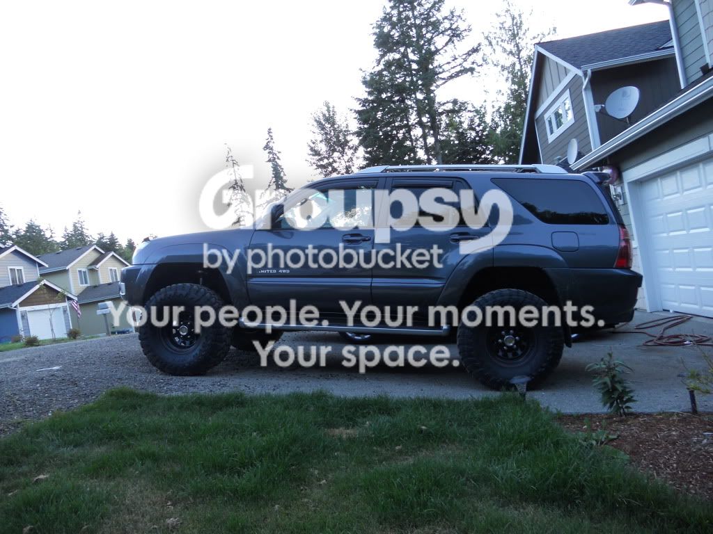

I installed an Overland Warehouse 2.0 lift and All Pro 1.5" wheel spacers on the 4runner last week along with some 33x12.50xR15 Toyo M/T's.
282491_1682573803552_1813824999_1109042_110660_n.jpg~original
285101_1686377858651_1813824999_1112255_5356416_n.jpg~original
195.jpg~original
196.jpg~original
The rims clear the rear brakes perfectly without the spacers but up front the face of the caliper is just too tall so thats why i went with a 1.5" spacer to squeeze those 15's in.
Currently there is some rubbing when turning and flexing in the rear. I bought a RB 1.5" body lift that I have sitting in the garage atm which im just dieing to put on there.

The spacers helped alot but the backspacing on the rims is what got them close to fitting. Ill try to get a picture of how close the rim is to the caliper to illustrate how tight of a fit they are.
Gotta ask why you went with 15's? Personally I don't like the look and having that much sidewall and flex, but I suppose they would be better for rocks when aired down. Good looking rig though.
I like the look of the tire on a smaller rim also when aired down you have less of a chance of popping the tire off the bead. It also didnt hurt that I took these tires and rims off of my 93 toyota pickup before i put it up for sale.

There is prob a 1/10" clearance between the caliper and the rim.

On Saturday I decidid to get up early, and when i say early i mean like 9am because i work swing shift and dont get home until after midnight. The goal for the day was to install my 1.5" RB body lift that had been sitting in my garage for the past year and a half. I used the write ups that you can find on the forums here as a guide and set off to finish this long overdue mod. Even with my fathers 3 ton jack and about 4 1" blocks of wood stacked on top this was still close to maxing out the height of the jack. I didnt want to take the tires off and put the truck on jack stands because i wanted it to be as stable as possible while installing the lift.
I ended up having to torch 3 of the body mount bolts and get them cherry red in order to spin the nuts off and them hammer out the bolts from the underside. With these delays and never having done this type of lift it took me about 9 hours to complete.
Here is a pic with the body lift and roof rack installed.

I still havent fixed my rubbing issue but it only rubs at about 90% of full left and right lock. Im going to have to do the body mount chop because while turning and the front wheel stuffed the tire and mount make contact and im worried about puncturing a tire on the trail.
