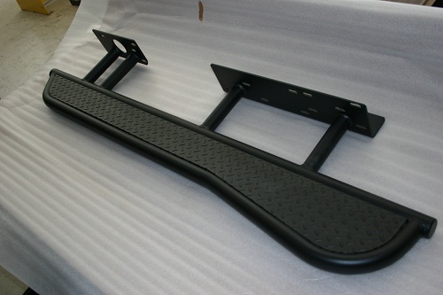

The only real problem I see is they will only fit TE's without KDSS from the frame detail pics. Wonder if they know about all the Limited's Xreas stuff along the frame rails and the 3+ inch lower rocker panels(can be cut or removed) on both the SR5 and Limited.It would take a new design to fit Limiteds,SR5's and TE's with KDSS .
Bud's full tread sliders would be my choice though if I really needed something more to stand on at about half the cost. But they take removing or cutting the rocker panels too on Limiteds and SR5's
