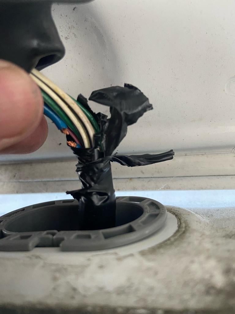

Just solved my rear window issues a couple weeks ago. I cut open the rear loom in the trunk hatch and bam!! Busted wire that I just added a longer wire to and re-taped it up. No issues after this.

jeesh, I wish mine had such an obvious wiring issue. been pouring through all the wiring I can find and I'm just not seeing any obvious cuts or exposed wiring. :ybrick:
