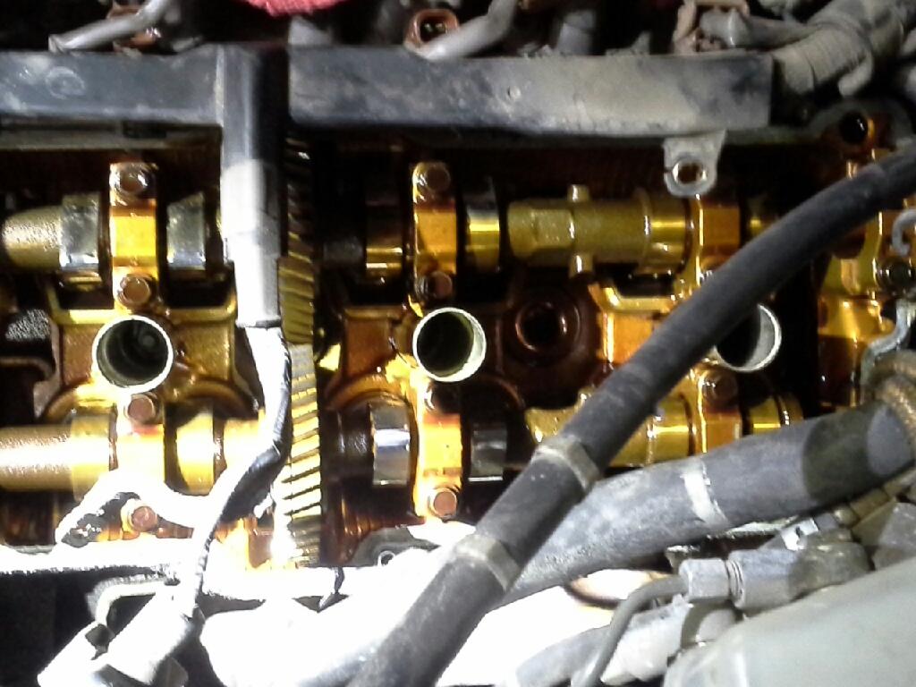

Bash me but this is what rotella t6 every 5k, 'motor medic motor flush' every oc for 5 mins and seafoam when i remembered in the last 300 miles before oc did for my valve train, just changed the leaking vc covers last week.
Not sure it was an "aggressive" cleanout but it is Clean. This cleanout occurred over 50,000 miles not overnight. Purring like a kitten at 277k. What a shame....
