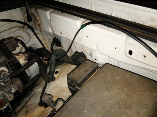

Another thing, maybe I am just being paranoid, but when I open the engine cover, I noticed there's this wire (tube?) kinda curve up on the side. I mean, I have never noticed it before, almost like someone pulled it up from somewhere down there. What's this wire? Could it cause the problem? LOL, anyone?
Thanks a bunch!
