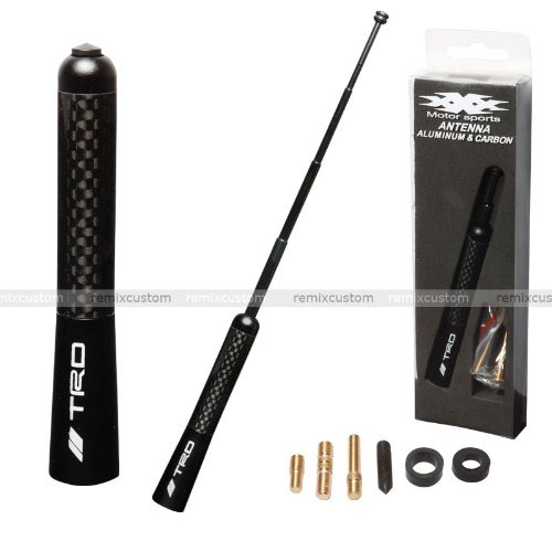

I've been toying with this idea and discovered this options
All in all The Tacoma mod looks the best AS well using the window antenna would be nice to. Another idea for the fender hole is a really nice spot to mod up for a cb antenna and just use the window antenna for the radio.
where exactly did yo find this TRD antenna......?
