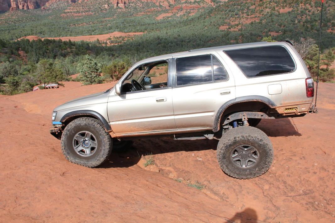

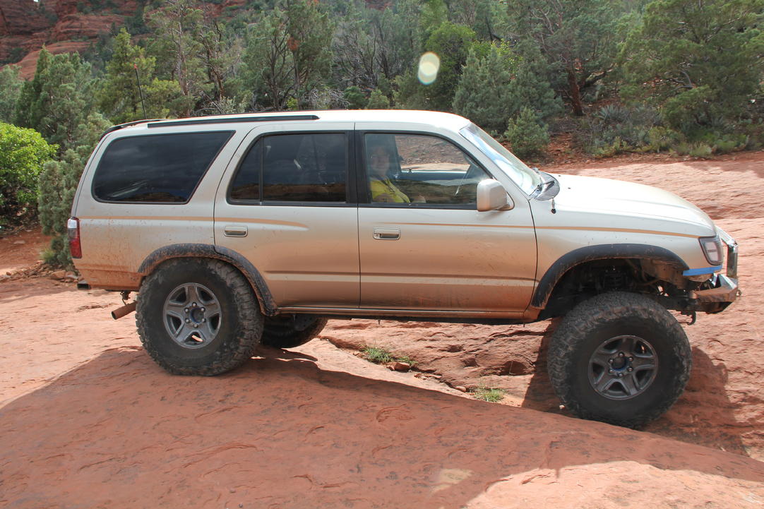

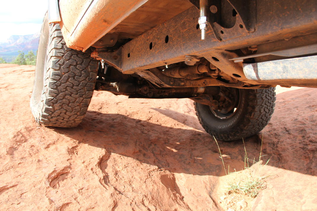

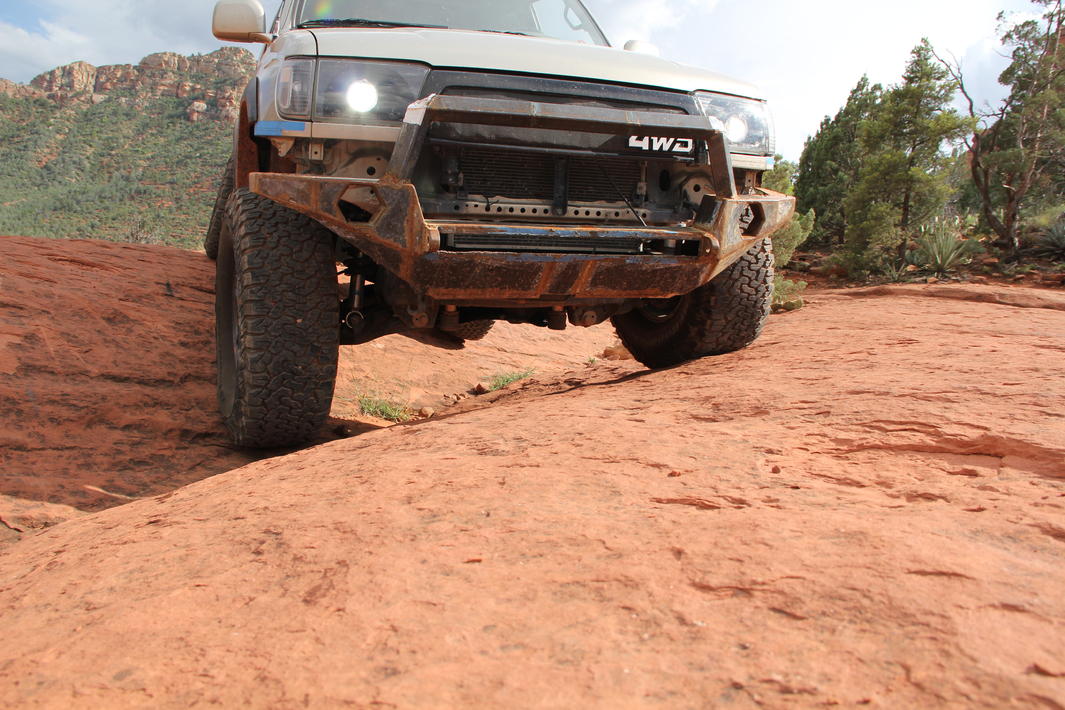

so a while ago you mentioned getting a bit more travel out the stock suspension by simply shortening the bump stops.
in the last months these are the things I have done.
1: trimmed and tubbed front to clear 35s with no rubbing on body at all, 1/2" clearance. it does rub slightly on the frame at full turn no matter the position of the tire travel wise.
2: got 35s and 1.25" wheel spacers on stock wheels.
3: made a 3" body lift with solid aluminum pucks.
4: aquired poly bumps from absalom and shortened them 1" and put in front position.
then left the old rear bumps. I also extended my rear bump stops and used chevy blazer soft bumps in the back. I cut of the top ring and used it in the front, by squeezing the poly bump into it.
5:then I tapered the body lift from 3" up front to zero in the back.
6:went to sedona and measured the travel up front all flexed out. I believe there may be an inch or so more up travel during high speed since the higher force would be able to compress the soft bump stop more than in a flex scenario. anyways 10"+ of travel up front with stock arms tundra 5100s and and tundra trd springs on first perch. also Im running about 1.5" of lift up front and about 2.7" of body lift in the front fender well, so it rides nicely and i dont have stupid looking rake.
