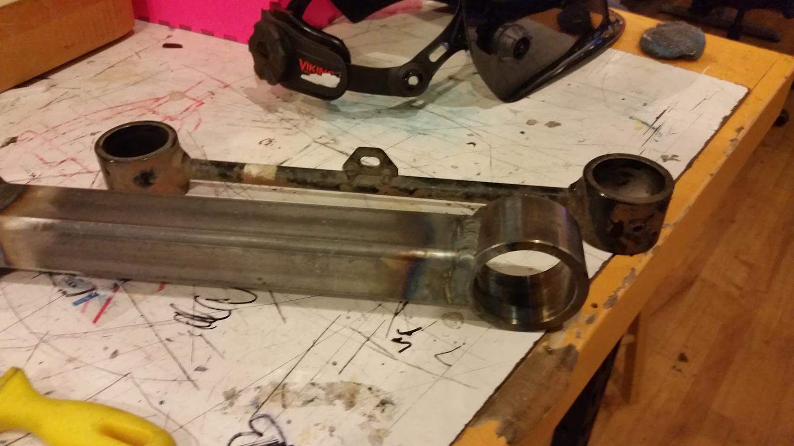

the way the linkages move in the back is not exactly logical. instead of sliding, the link forces the rubber to flex and the metal tube stays stationary. because of this, the torque spec is very high on these, i believe they are over 100lb ft. one thing that is not mentioned anywhere is that after you change the ride height of your truck, lift it, you need to go and undo and retorque all of these rubber bushings so they are relaxed at ride height. I have never ever seen anyone mention this in any lift tutorials nor instruction manuals, i figured it out when i loosened my rear links and saw them twist. the bonded bushings are great for cars but i cant believe they use them on something that has more than 4 inches of travel. anyways, im working on some links with poly bushings, and they slide around instead. got the uppers done, and half way done on the lowers, I used 4th gen poly bushings from energy suspension, and they are the beef.
also how is that speed sensor ring attached on? I was thinking if i machined my own I could press it on, and do the same on the front, in order to correct my tach and speedo.

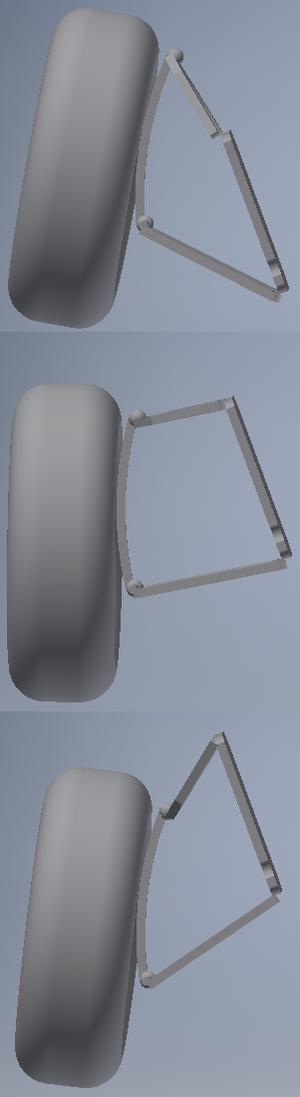

You are absolutely correct, camber gain.
Desert racing vehicles do still have unequal length arms usually, but the difference in length between the upper and lower arms is small because with all that damn travel they have they still get the same camber gain properties in the end.
Btw that story about the jeep kids taking their internet points photos then leaving was hilarious. Never saw very much of that at my school, New Mexico is too poor to have privileged kids like that.
ive also heard its to minimize tire scrub, due to change in track width. from what i understand and have seen, at full bump the top of the tire angles inwards /....\, then at ride height the tire is straight up and down |--|, then at full droop the top of the tire angles inward /''''\. this would keep the track width equal throughout the entire cycle since the track width would narrow if the tire remained verticle, but during cornering it would still allow the tire to have negative camber with respect to the body, preventing it from suddenly folding over or something weird. if you were rock crawling equal length arms with the joints spaced farther on the tires than on the frame would give you a solid axle effect, this is kind of like the horrible yet effective ford twin traction beam ifs.
edit: here this is better than forward and back slash, i need to take some actual measurement and plug em into my model here, then we can see how much travel we can really get out of the front end, I suspect not much more than 11".
That is how all rubber bushings are intended to work.
Regarding the rear links.. you are partly correct. The bushings do rotate as the suspension cycles, but they also have something called a pry angle, which is found when the rear axle has non-uniform movement (aka flex). What this means is that when flexing, the bushings allow the link to rotate axially so that the bolts on each end are no longer parallel.
Poly bushings do not allow this movement, so you can start breaking control arm mounts if you don't build some rotational ability into those links.
Sorry if I come off like a know it all douche, but I know this because I also made this mistake and had to remake the RR links that I built to have more axial rotation. See here:
Ripcord's Build: RR Links
Just trying to save you the headache :rapture:
Finally, regarding the speedo. Since you are pretty handy I figure this would be the easiest and cheapest method for you.
