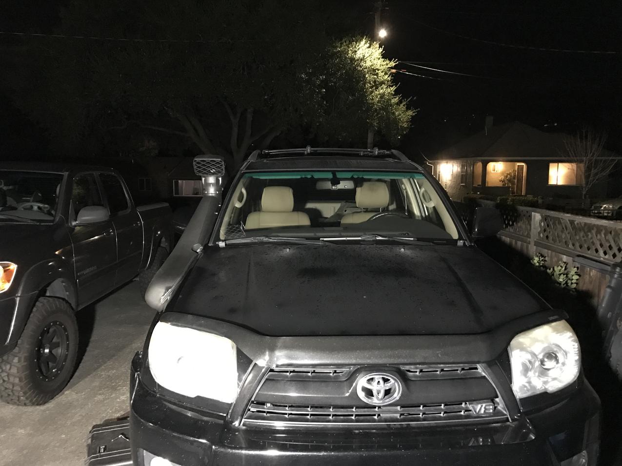

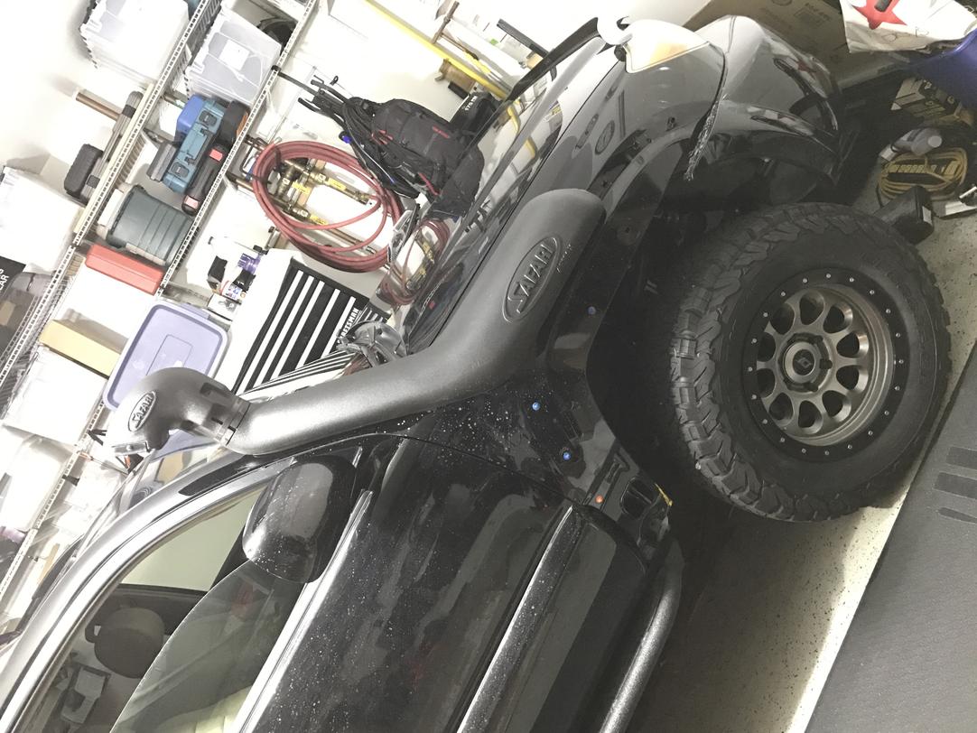

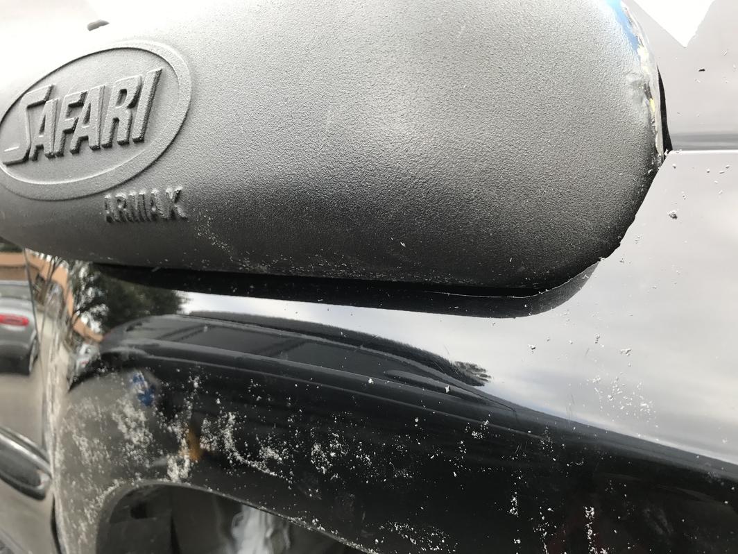

I just finished mine. I used the Safari Snorkel SS171HP intended for an '05-15 Tacoma. I preferred the chunkier look and the improved airflow of the ARMAX design. I cut the flare to fit around the snorkel and used stick-on rubber gasketing between snorkel and body to hide the small gap (3/16"). I did use a heat gun to form the snorkel to the body.
Looks good!

Nice, yours looks nice and tight to the body and your snorkel intake is nice & straight! I noticed some had to change the angle of the pipe to get the snorkel to fit the Pillar which causes the snorkel intake to be crooked. That was the major reason that I wanted to try the SS171HP, instead.
My fender was mint as well. And even though, I knew the snorkel would cover up the holes, I was still seriously sick to my stomach drilling two 4.5" holes and a bunch smaller smaller holes.
Thanks. It fits pretty good but I did have to heat and re-shape it to get it there. I've drilled, cut, welded other vehicles and I didn't really think twice about it but I really had to think it over before drilling in this fender. I guess you could say I'm a little attached to this 4runner, lol.
