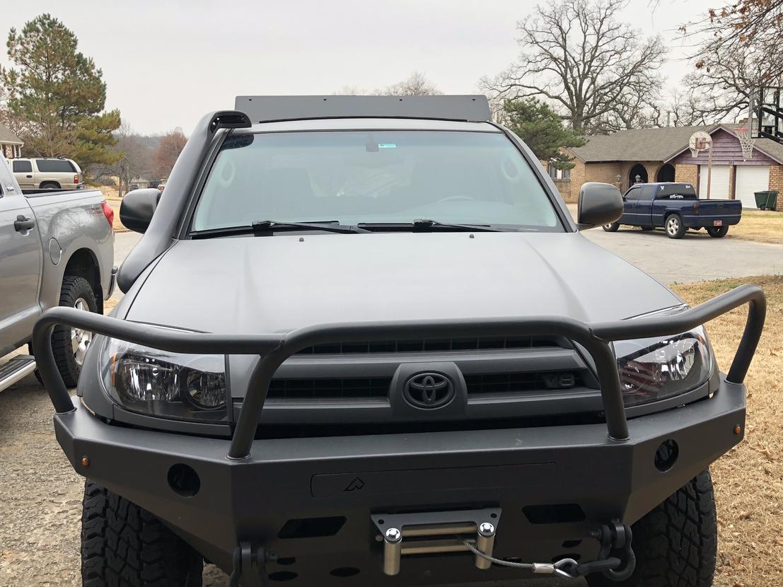

I've been looking into a snorkel after getting a front bumper, since the intake hole is exposed to the elements. I'm worried one of these days, i'll just hydrolock my motor with my luck.
With that said, I've looked into the LC80 snorkels but they stick out way past the roof of the car. Going to places where I occasionally need to park in a parking structure, I can't manage to have a snorkel that sticks out way past the roof like the lc80 does. Are there any other options for a snorkel that is low profile?

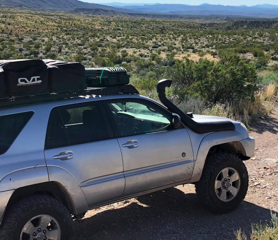

Example: This is the LC80 snorkel from another thread. See how it sticks past the roof line?
VS a snorkel on a tundra sits at or below the roof line...

Good luck finding many options. I'm sure you know, it seems our 4th's really get the least amount of love in AM stuff compared to 3rd/5th's, and the snorkel seems to be one of the less popular mods acknowledged.

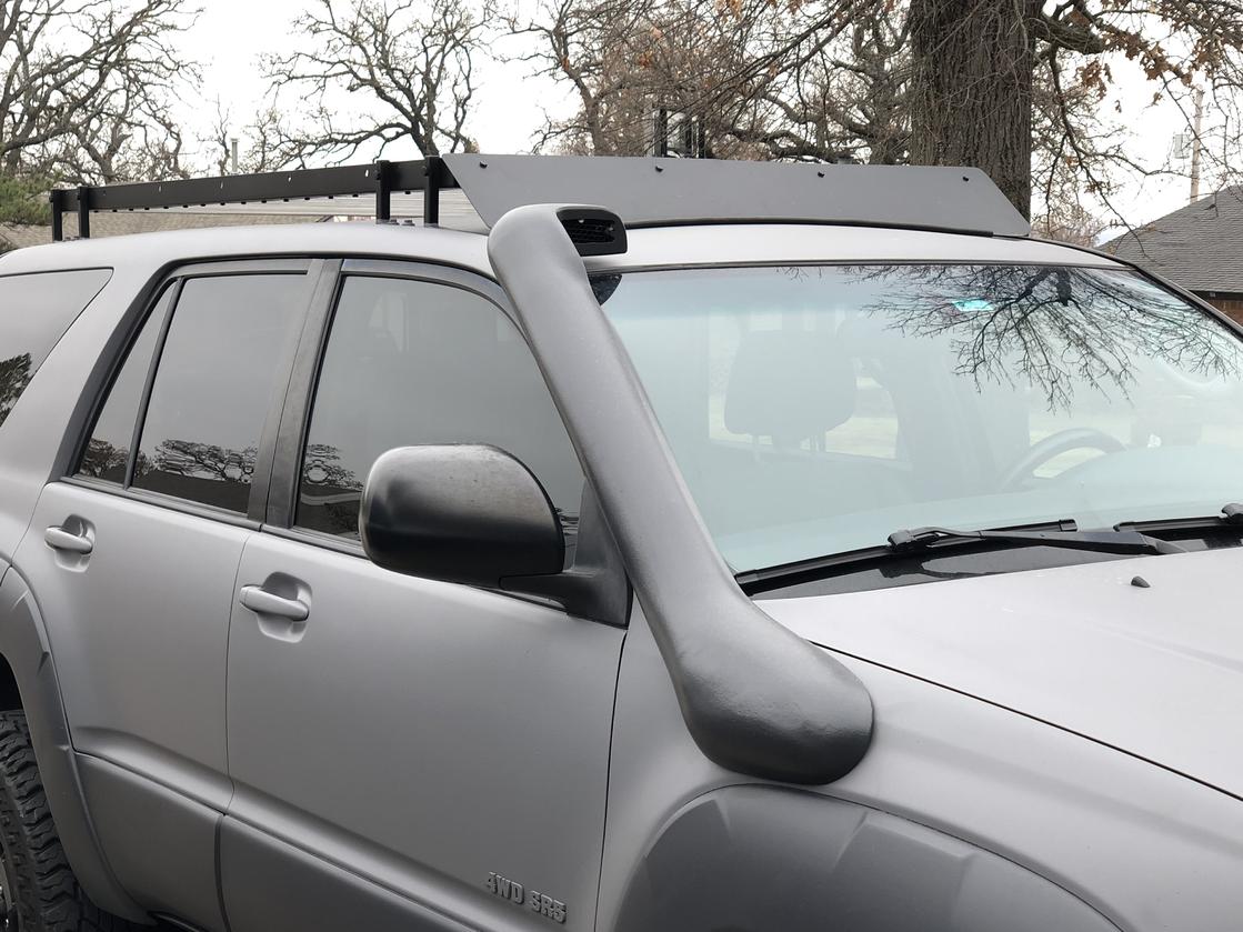

Not entirely aware of how, given the material of the snorkel, but could there be a way to hack up and "shorten" an LC80 one? Guessing it's plastic of some sort... Take an inch or two off below the "intake head", and reattach with JB Weld. Then alot of sanding/paint to make it look good. I've yet to see/hear JB weld failing on anything.
Trimming the lc80 snorkel does help. It is still higher than the roof, but it helps a lot. I trimmed about 1.5" off the top of the tube, then reinstalled the head. No JB weld or anything required. That was about as much as I could remove without modifying and bending or welding the plastic itself.
I just wanted to get the top level with the top of my roof rack.

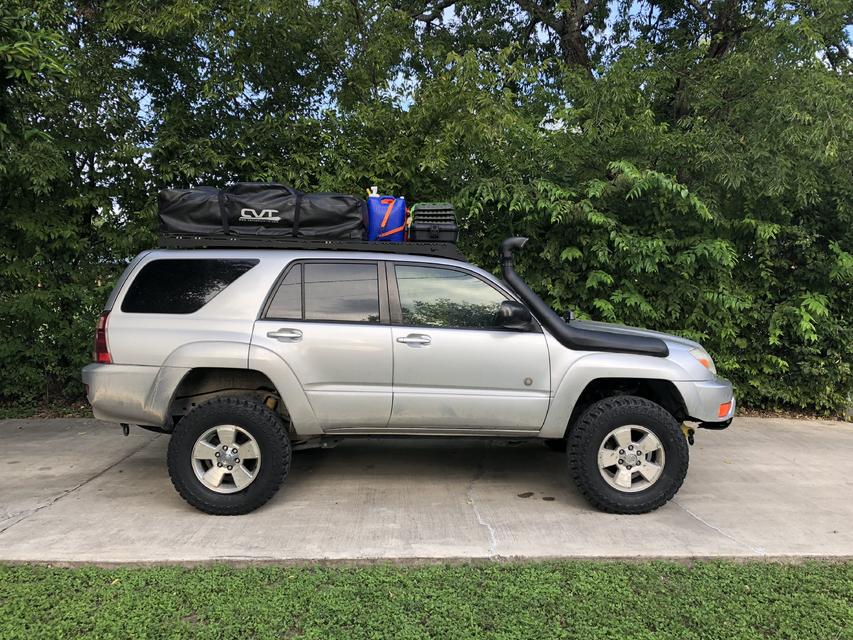

I did the same as you for my LC80 snorkel and it sits about the same. I wish it was a little shorter but it's not the end of the world.
I've seen a few pics floating around on the web of 4th gen owners using 1st gen Tacoma and 2nd gen Tacoma Safari snorkels. They come out good but I didn't want to gamble with a $450 snorkel.
It's not too bad, depending on the angle you look at it from.

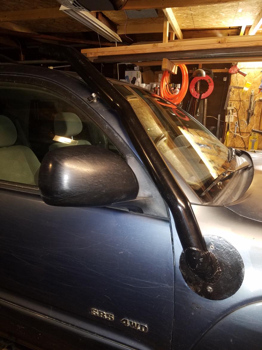

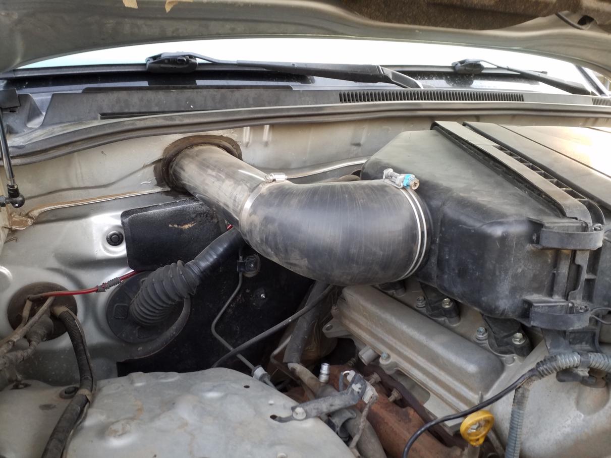

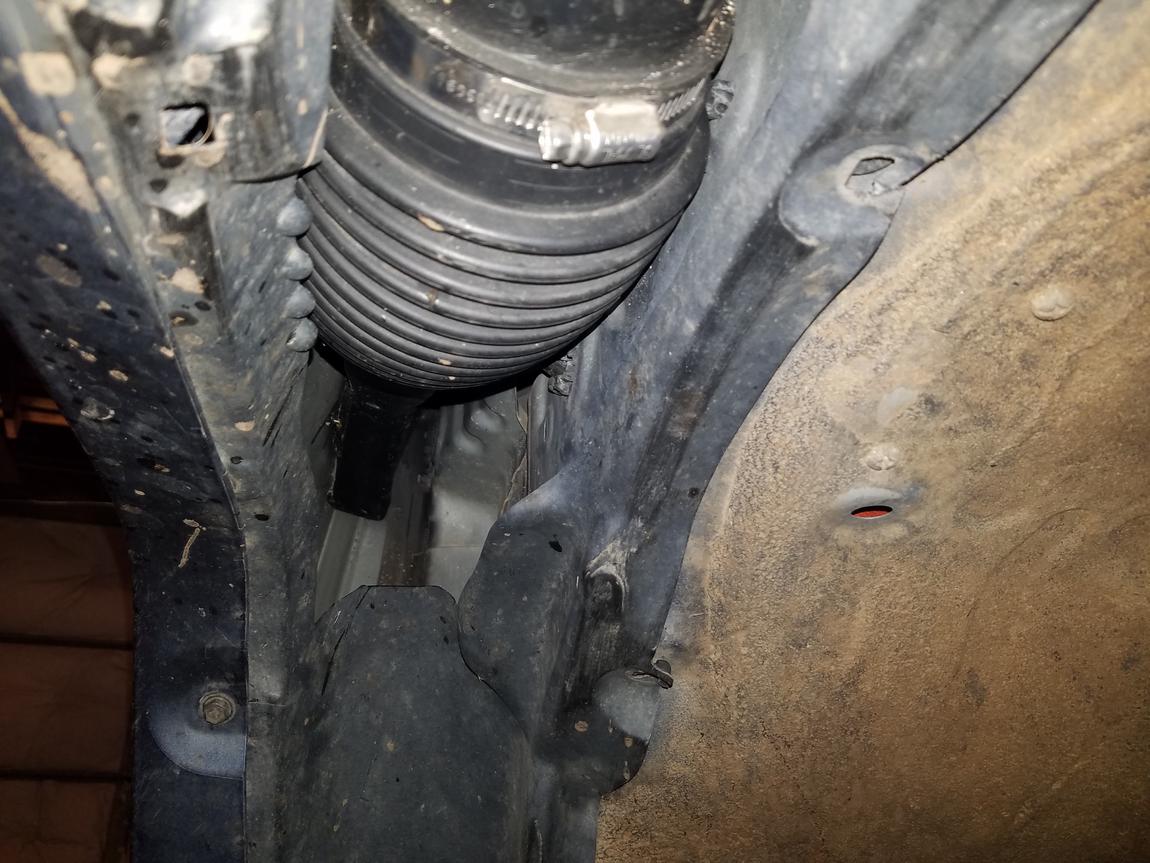

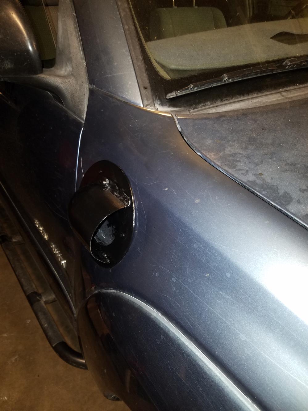

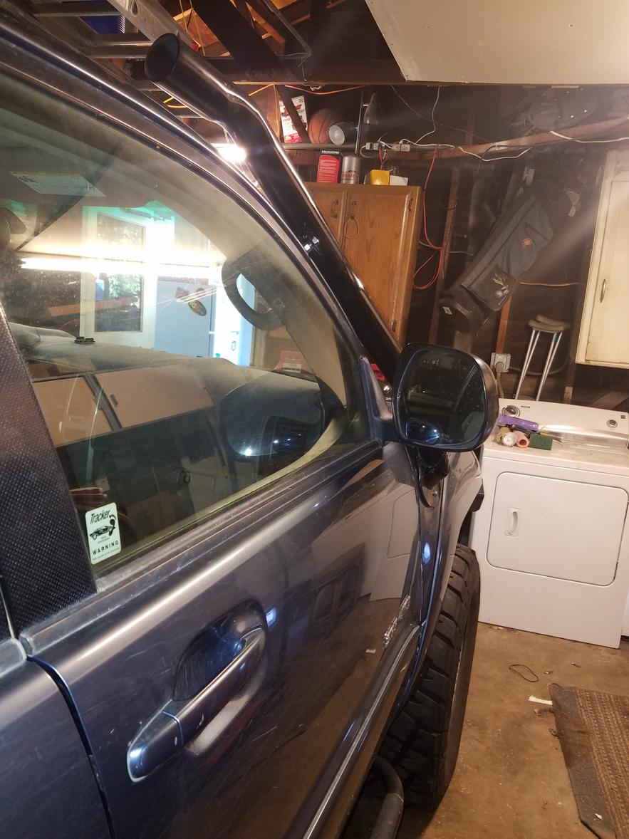

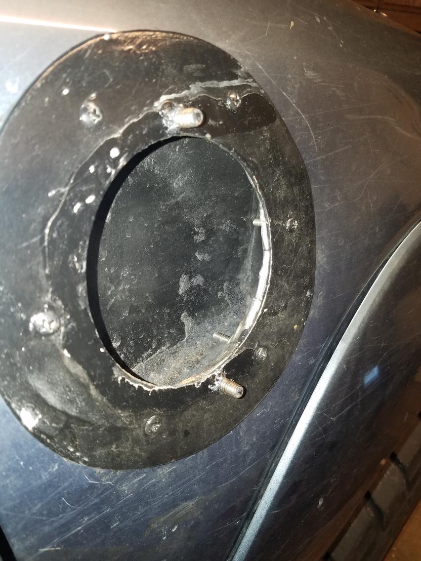

I made a detachable waterproof snorkel that can be stored in the truck when not driving underwater and installed in minutes when you need to cross a river. I had it made of 2.5" exhaust piping and I simply welded together a waterproof box with stainless studs that goes through the fender and attaches to a detachable cowl (gotta have that ram-air ) that bolts on when on no snorkeling is needed. more pics of the snorkel shortly.

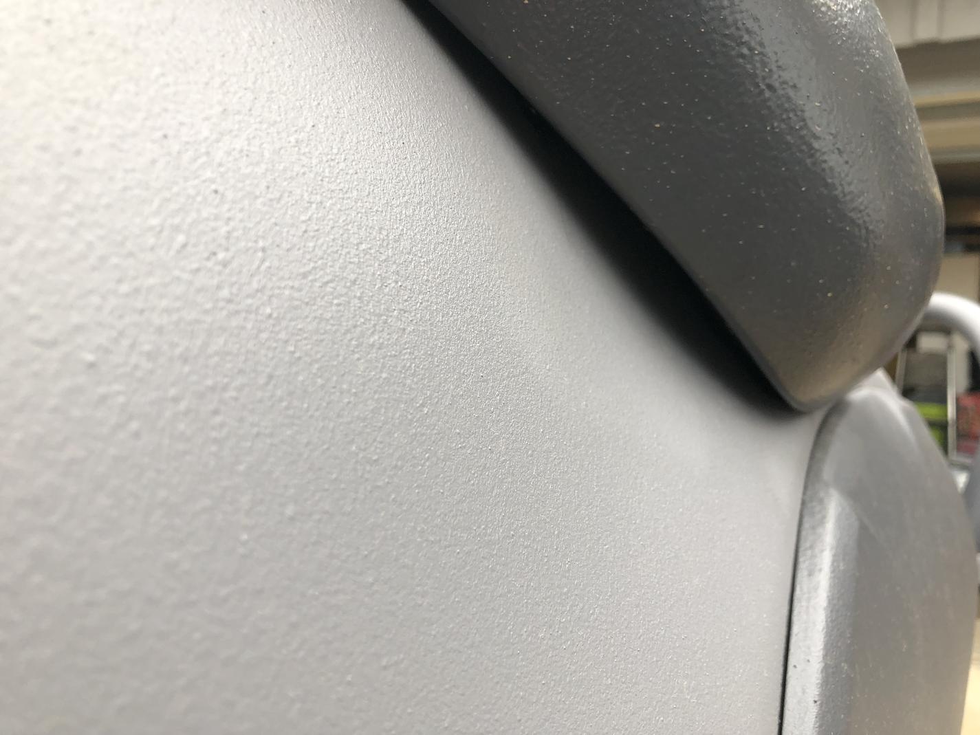

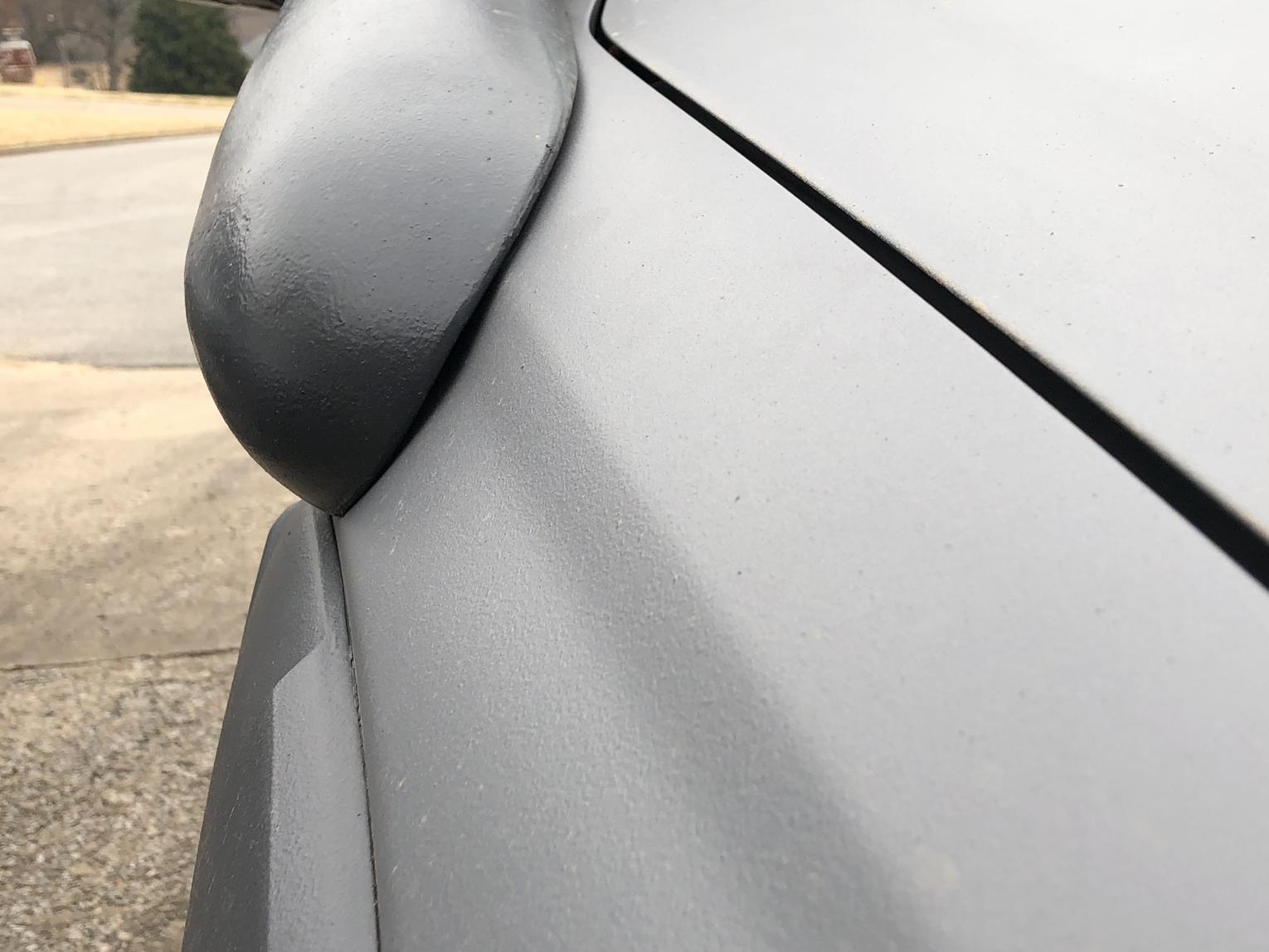

Have this one on ours. I will try and remember to take a pic tomorrow. It does have the word “Powerful” molded on the side of it, or at least the one I got did. The one pictured does not have it. I sanded that off and painted the entire snorkle with Monstaliner to match the 4Runner.
https://www.ebay.com/itm/4x4-Air-In...326490?hash=item41caebd19a:g:WlEAAOSw2bFcB5uE
Placed order and received it in about a week. Quality seems fine to me but I have never seen an ARB up close either.

Yea, trimming the LC80 snorkel just a bit was on my mind, but I didn't think it would bring down the ram low enough for my liking. Still a bit iffy on how high it overhangs the roof, but I appreciate the pics. Truck looks good setup how it is though :rockon:
It's definitely not the end of the world, but i'd hate to have to remove the air ram portion just to get into a parking structure.
Hmm, I might look into the 1st/2nd gen tacoma snorkels. Thanks for that!
That's actually quite interesting, but seems a bit over my DIY skill level. haha
Happen to have a picture of it mounted on the truck?

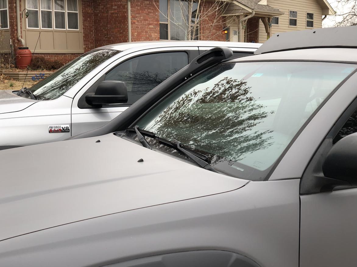

It is a knockoff of the TJM design from Australia that they make for a 100 series.
Doesn’t fit up against the fender perfectly but it’s also not made for a 4 runner. Probably about 1/2” gap in back but not really noticeable.
