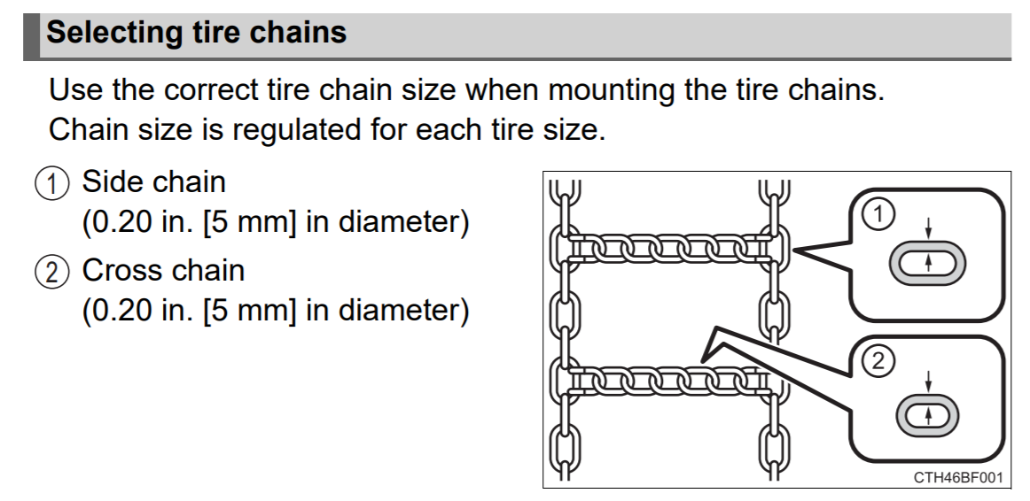

I've got a 2020 4Runner and replaced tires with Falken WildPeak A/T3W in stock size, though they're naturally slightly larger in diameter.
Looking at the owner's manual, it states "Install tire chains on the rear tires only. Do not install tire chains on the front tires."
Yesterday I did a bit of mountain road driving, had somewhat basic chains on my rear tires (want to get better ones!) but not having them on my front tires felt... not so great. I ended up sliding sideway on a hill, which I firmly believe wouldn't have happened with chains on the front.
Anyone running chains on the front? Any precautions or things to note? I imagine it has to do with clearance issues in the front, but shouldn't the 4runner wheel well have "plenty" of space, especially compared to the compact/luxury crossovers that have almost none?

My 2020 owners manual (attached) seems to show the link diameter shouldn't exceed 5mm, which unless I am mistaken is on the very small side?
Having written many technical documents for complex systems I realized that you need to do more than telling a user “do this” or “don’t do that”. They need to know why. You have to give them a decent understanding of what you’re trying to accomplish and they’ll comply. Otherwise you get callbacks from a customer who didn’t take it seriously, or thought they knew better, and did something wrong or in the wrong order and they damaged an expensive machine. Then you have to help them deal with a remedy.
So it drives me nuts when so many businesses do the absolute minimum required documentation. Toyota’s owner manual is a fine example. To help the owner understand and comply it needs one more sentence about why no chains on the front wheels. And one more on why the specific diameter of tire chain is required. I’m sure you all can think of several more. Like why the motor oil specified. Or the limitation of the 400W/100W inverter operation. Otherwise we all wonder, guess that it’s not a good reason, then design a hack to overcome it.
BTW, I’m guessing that specified tire chain diameter is so the chains stay flexible enough to be stretched and fit snuggly on the OEM tire size. So they’re not too high and won’t sling around too much.
