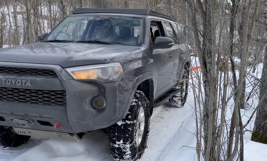

I run chains on all 4 going to the cabin, it’s a narrow trail with short steep hills. 4 low and slow!! I had to trim the bottom of the front bumper but everything is good now.

i personally wouldn't put chains in the front, if the chain accidently hits the spindle and deflects into the brake line or speed sensors.......you will get the christmas tree dash lights.
