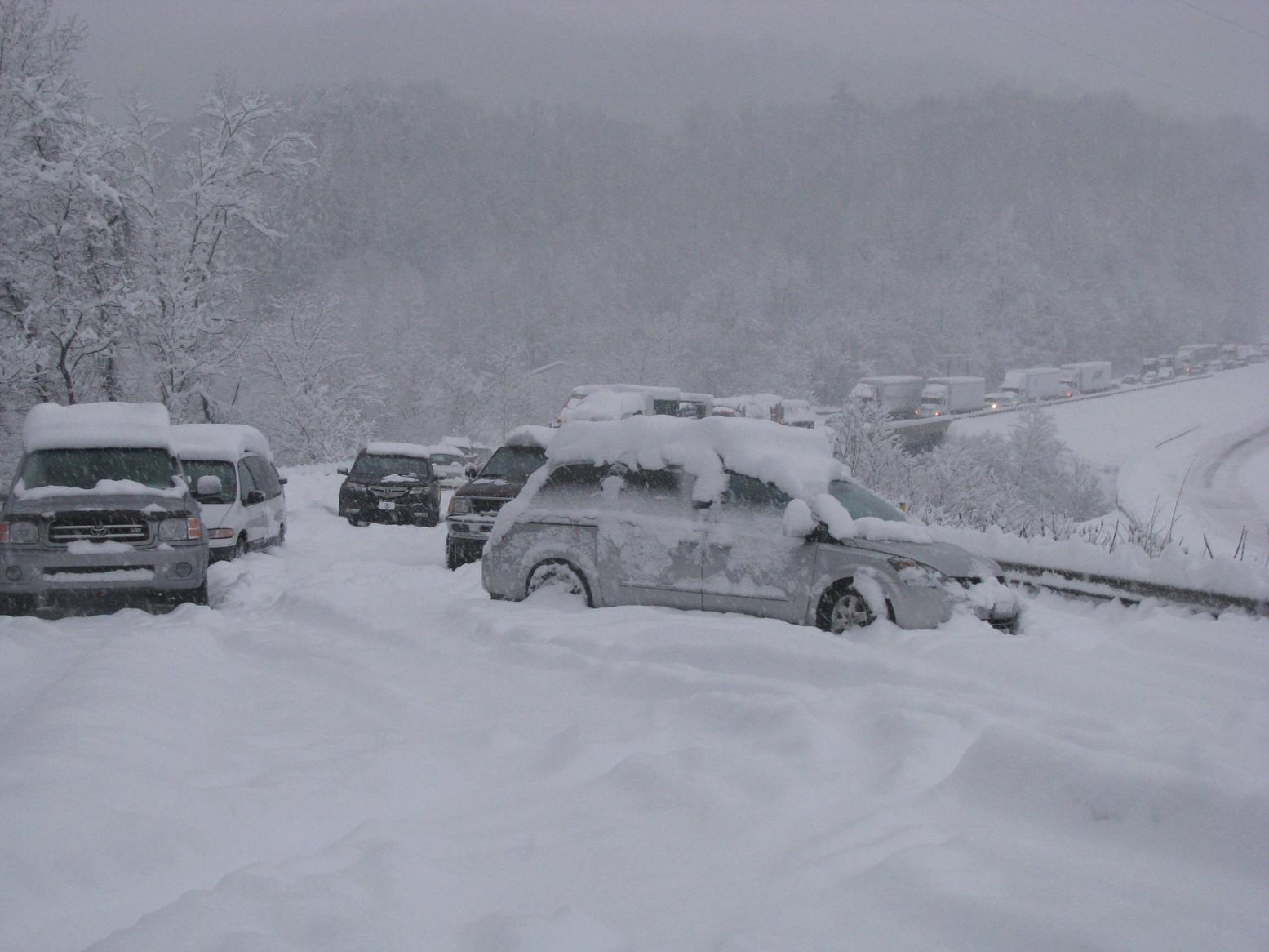

I noticed that you live in Kentucky. While we do occasionally get hammered here, most of our snowstorms are light (under 6") and my advice would be to keep your stock wheels and put a good modern AT tire on them. Cooper AT3, Toyo AT2, Hercules AT2, something along those lines. You'll never have a problem and you can run them year-round. That's what I'm doing.
