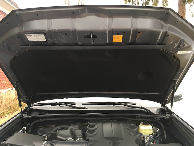

While changing my LED's to HID's today I noticed that the rubber seal on the hood does not go all the way around the hood.
I have a ford fusion and honda ridgeline and both of those have a rubber seal going the full length of the hood....
with the hood closed you can see the plastic cover that goes over the radiator....it looks like this is where the snow gets in........
I may add my own seal to the ends of the hood..

So based on the OP's post, I have been driving out in the rain today and popped open the hood back in my home garage. There was a little bit of a drip line on the front most side of the radiator shield. I did notice that further in on the hood there was a rubber gasket but it did not cover the entire width of the hood. I would say it lined up to the headlights leaving that area exposed.
Even so there was still not a lot of moisture in that area under the hood. My guess for the OP would be to check the gap when the hood is shut and see if it can be adjusted if too much is showing.

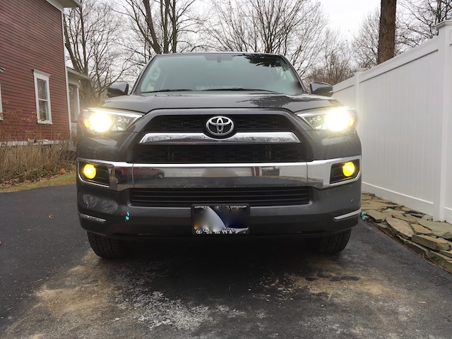

both headlights have moisture in them too.....thought it was the LED's and tried the HID's but after an hour driving tonight there is even more moisture......

I didn't notice any noticeable gap between the headlights and the hood....but I have nothing to compare it too.....pic of the hood head on....
