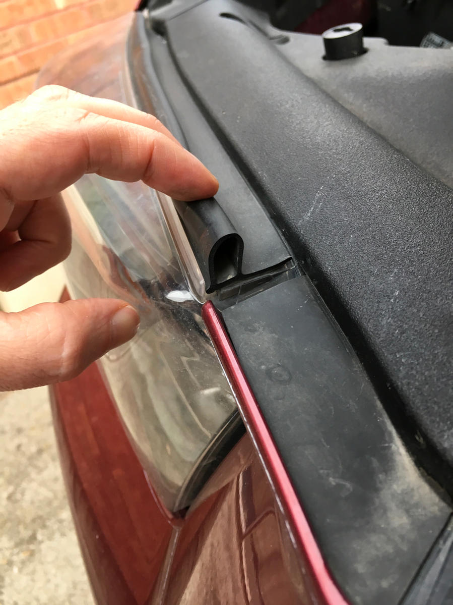

[MENTION=146325]Bucko[/MENTION] do the top of your headlights have rubber seal trim? Looks kind of like the trim around your door jams.

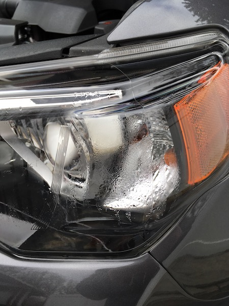

took a shot of the drivers side light, there is about twice as much moisture as shown after I drive for a bit...this is after sitting over night.
I didn't see any gasket like the doors have but when I lift up the plastic that goes over the headlights.... where the front and back of the headlights are sealed I see spots where there is clearly some gasket sealer and other areas where there is no sealant .....that I can see at least...
I have the older trim, this is what mine looks like. I have minimal issues on the drivers side where the dumbass that installed my hood wrap cut the weather seal.

I may add some after market seal like that.....I'm getting a couple of new dust covers for the back of the headlights (drilled holes in the original for the HID grommet) and I'm going to install the original Halogens and see if the moisture goes away.....if not then Toyota said they would replace the headlight assy.
