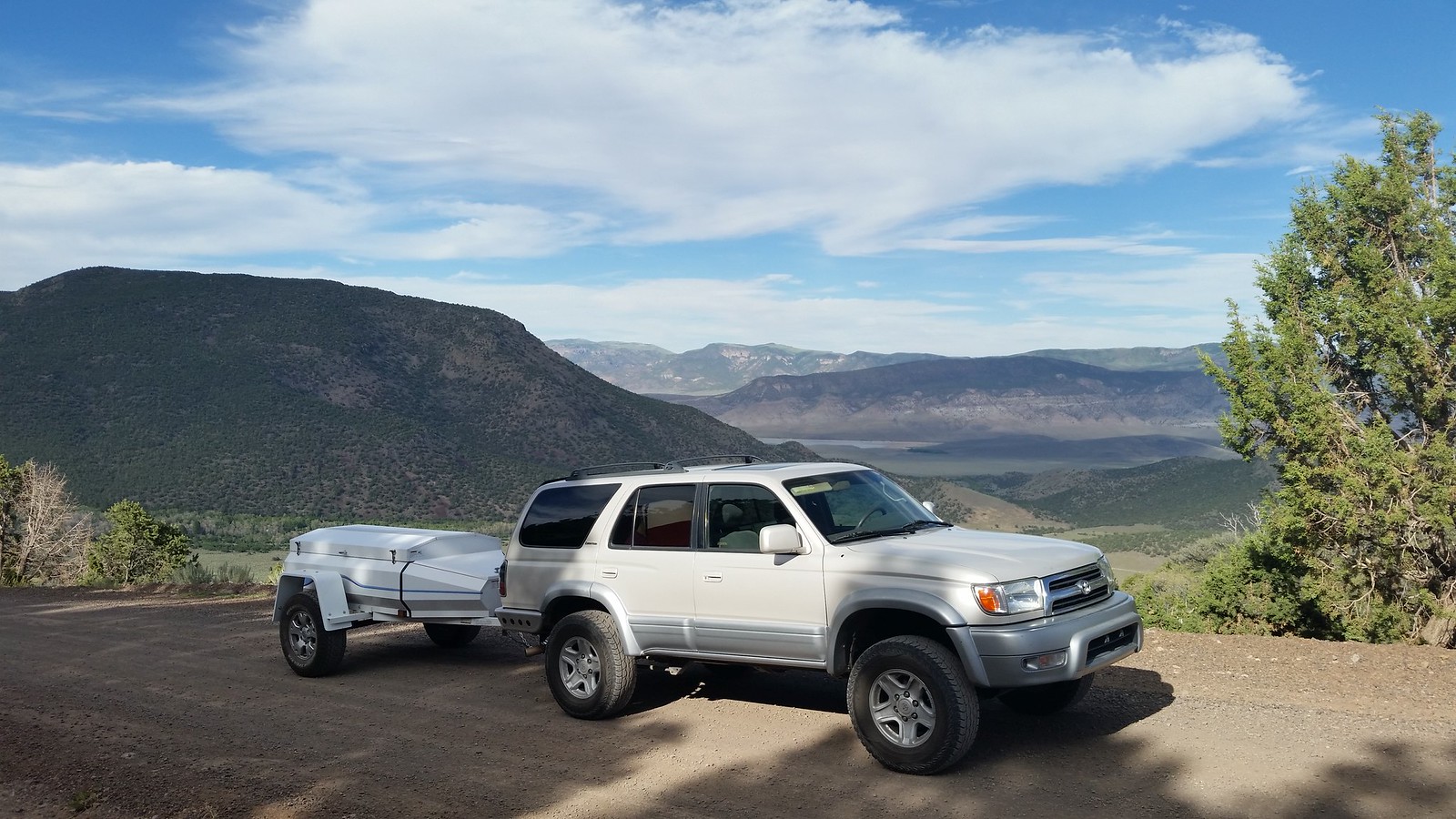

Current Mod thread... this will be edited with mods and things as I change it (and update the post)
current Mileage 180,XXX = 2/16/18
<a data-flickr-embed="true" href="https://www.flickr.com/photos/133970401@N04/24137950289/in/datetaken-public/" title="20160116_140134"><img src="https://farm2.staticflickr.com/1613/24137950289_4558a057d8_h.jpg" width="1400" height="787" alt="20160116_140134"></a><script async src="//embedr.flickr.com/assets/client-code.js" charset="utf-8"></script>
As I Bought Brand New to me
OD : 152,575
One Owner
sitting next to my 97 4runner
<a href="https://www.flickr.com/photos/133970401@N04/18717885851" title="20150611_075654 by Richard Gunn, on Flickr"><img src="https://c1.staticflickr.com/1/344/18717885851_8bd15accab_z.jpg" width="640" height="480" alt="20150611_075654"></a>
3.4 v6
4x4 with limited multi-mode
Tan Leather interior
Rear Dif Lock
limited 5 star wheels
265/70r16
Running Boards
Tow Hitch
Roof Rack
Stock front/rear bumpers
fog lights
