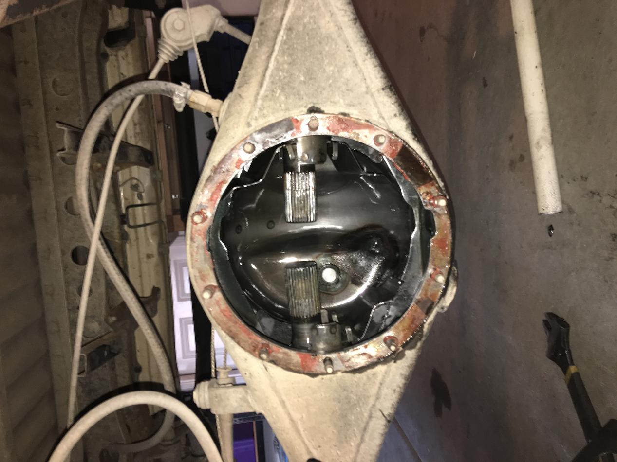

Finally getting around to installing that spool I've had on my shelf.
Have to wait to regear until next year, just going to go straight to 5.29s when I do though
