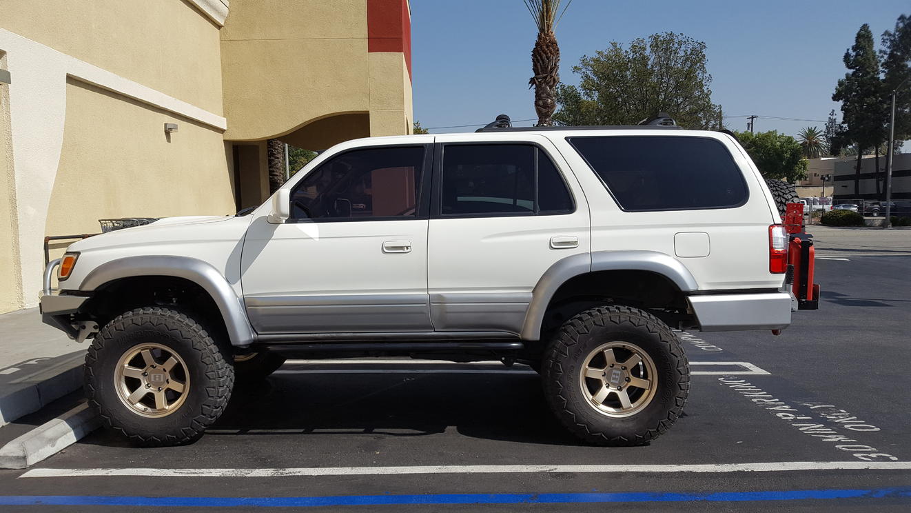

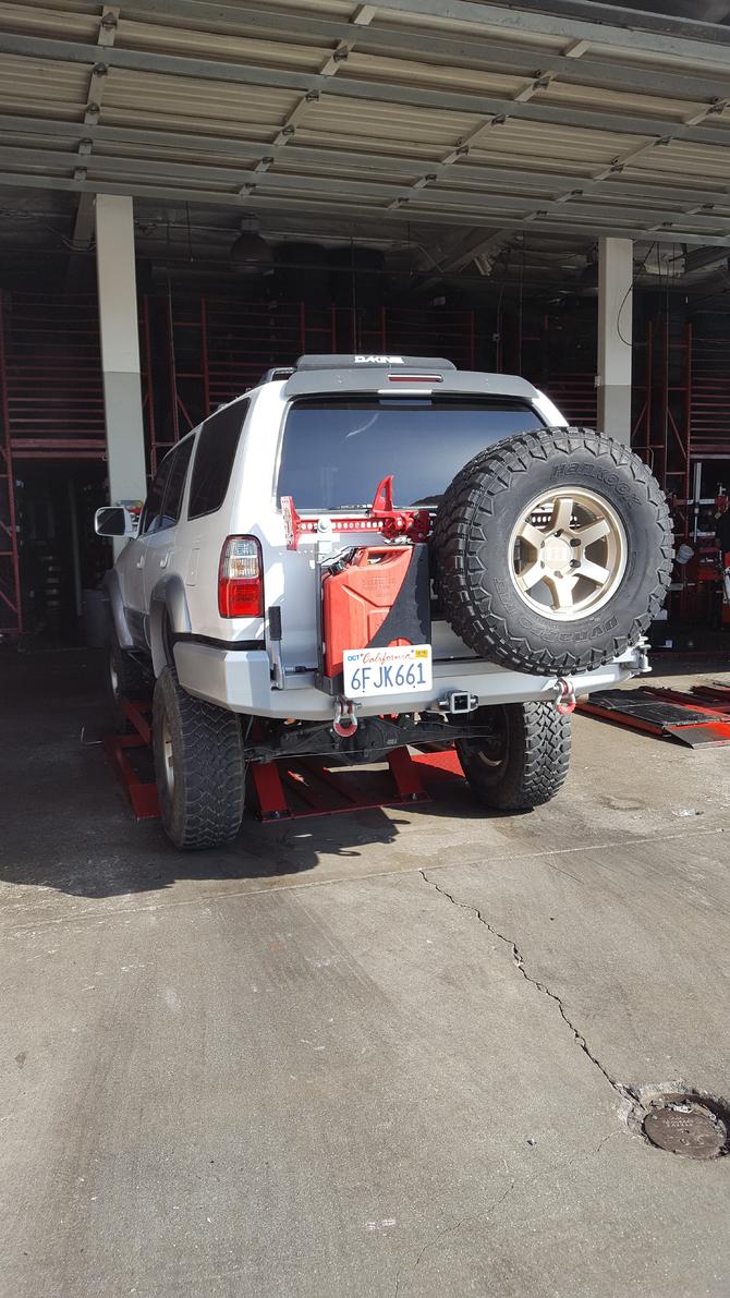

Got some gears and lockers for the mall. Working on the 3rd member right now. Think I got all the shavings out.
