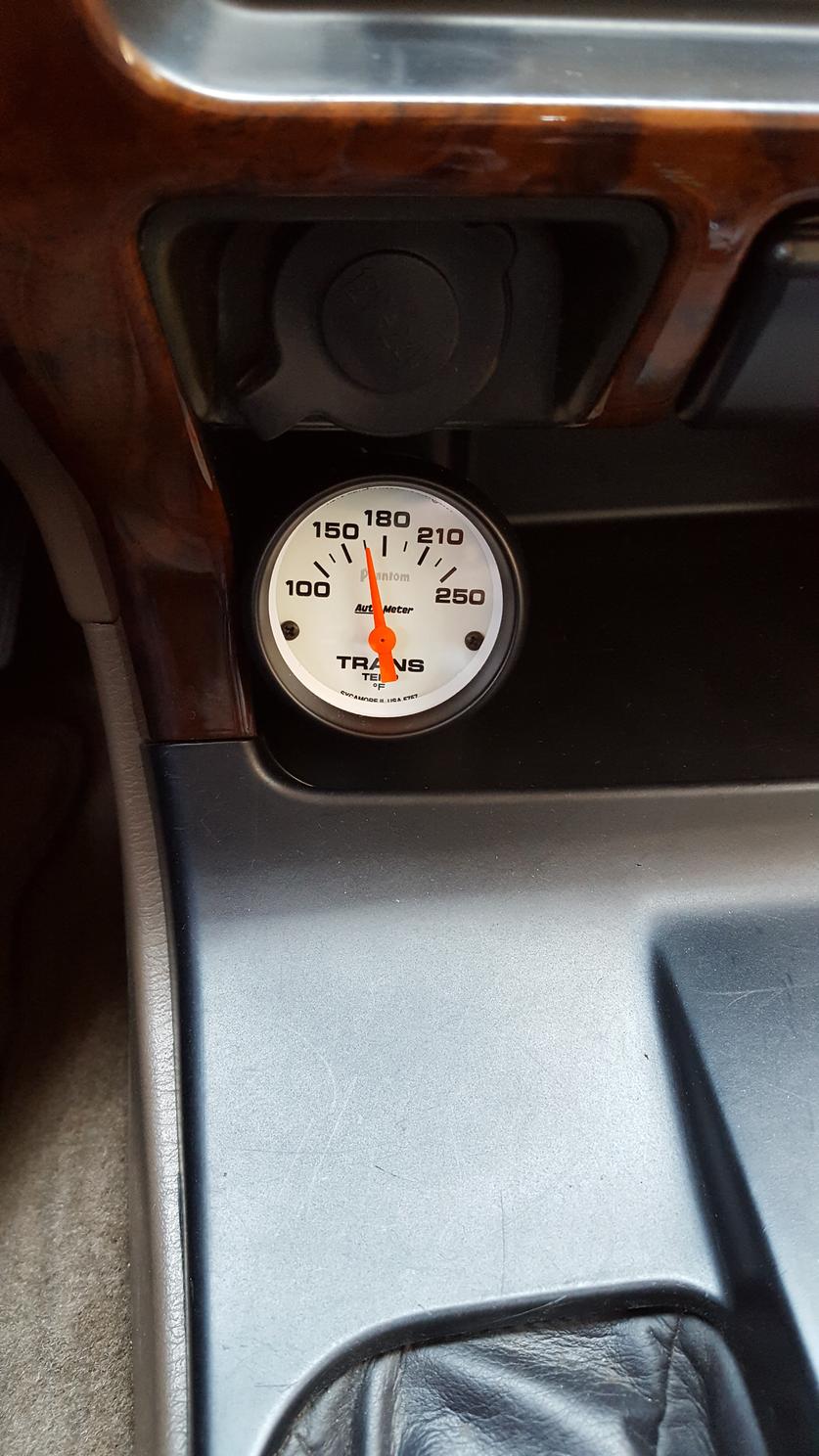

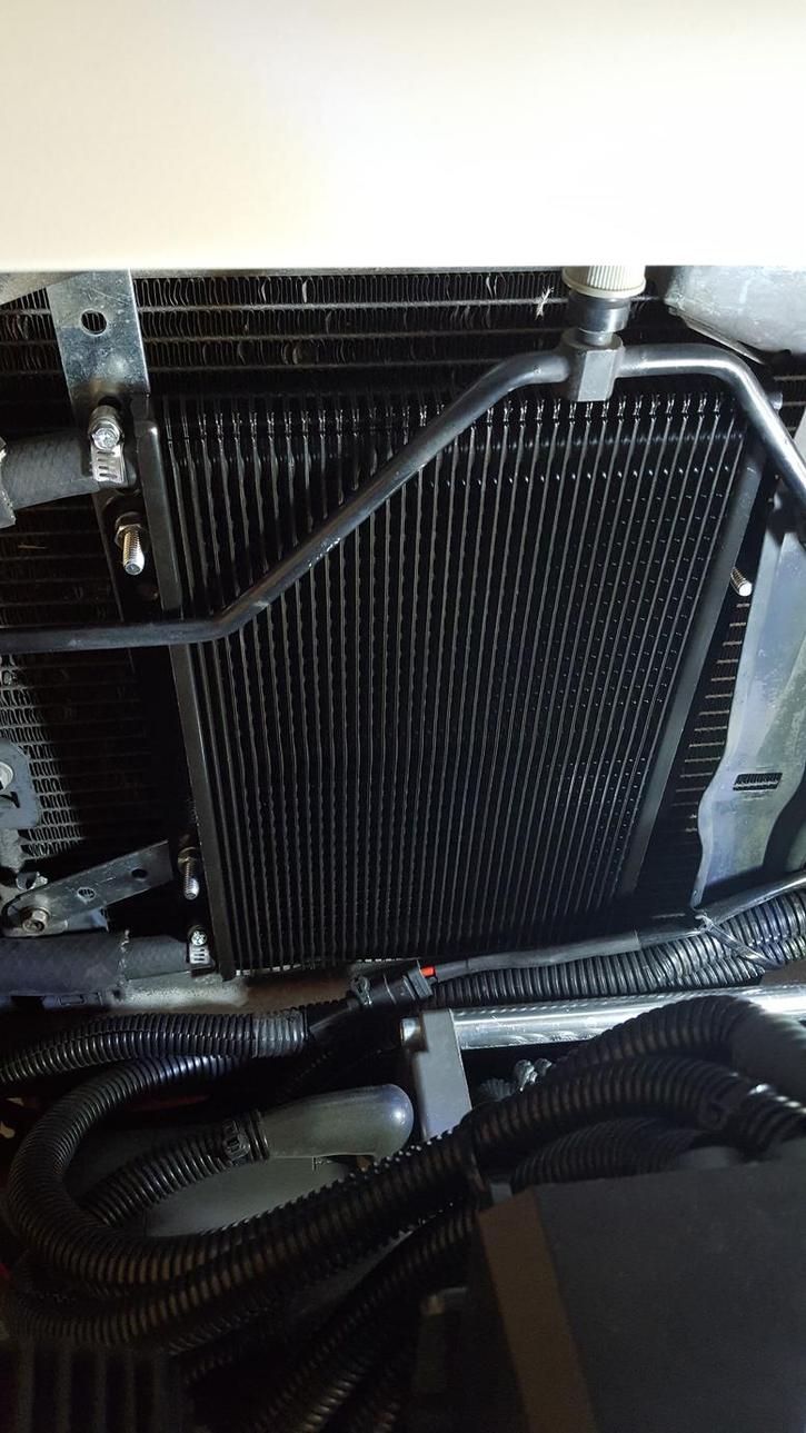

Installed some goodies that past weekend. My tranny temp never got higher than 180 with the A/C on and the outside temp being in the 90s. Enjoy.
Nice work Danny! I'm going to start tackling the radiator and trans cooler this afternoon. Just to make sure, you didn't bypass? You took the trans hose off from the radiator inlet (driver side, cooled trans fluid to tranny)? Connected a hose from radiator inlet to top of the trans cooler? Then from the bottom connector of trans cooler connected to the trans hose connecting to the transmission? Let me know. I'm reading bypass and don't want to do that.
I bypassed the stock cooler. I don't want any chance of a failed seal destroying my transmission.
The B&M covers have an internal bypass to get your trans get up to operation temp, then it opens up to keep it was there.
Yes, I did NOT bypass. I only did this because my radiator is only a year old. If you bypass I would recommend a larger cooler than mine (B&M 70268). After reading many posts, I've made the decision on keeping it IN-Line with the radiator because many have posted that the temp definitely drops more as opposed to completely bypassing the radiator. So it really depends on what you want....eliminate all possibilities of strawberry milkshake with higher temps or lower temps all around but still have the possibility of the milkshake. If you have a new radiator and plan on keeping up the maintenance, I would definitely go with In-Line.
According to B&M you can mount it 2 ways: nipples facing upwards or sideways, never downwards. I mounted it sideways and if you go this route the output from the driver's side radiator goes to the BOTTOM nipple and comes out the TOP nipple back to the transmission. B&M says this is the correct way to prevent air pockets. Other manufacturers might have a different configuration but B&M says to run it this way.

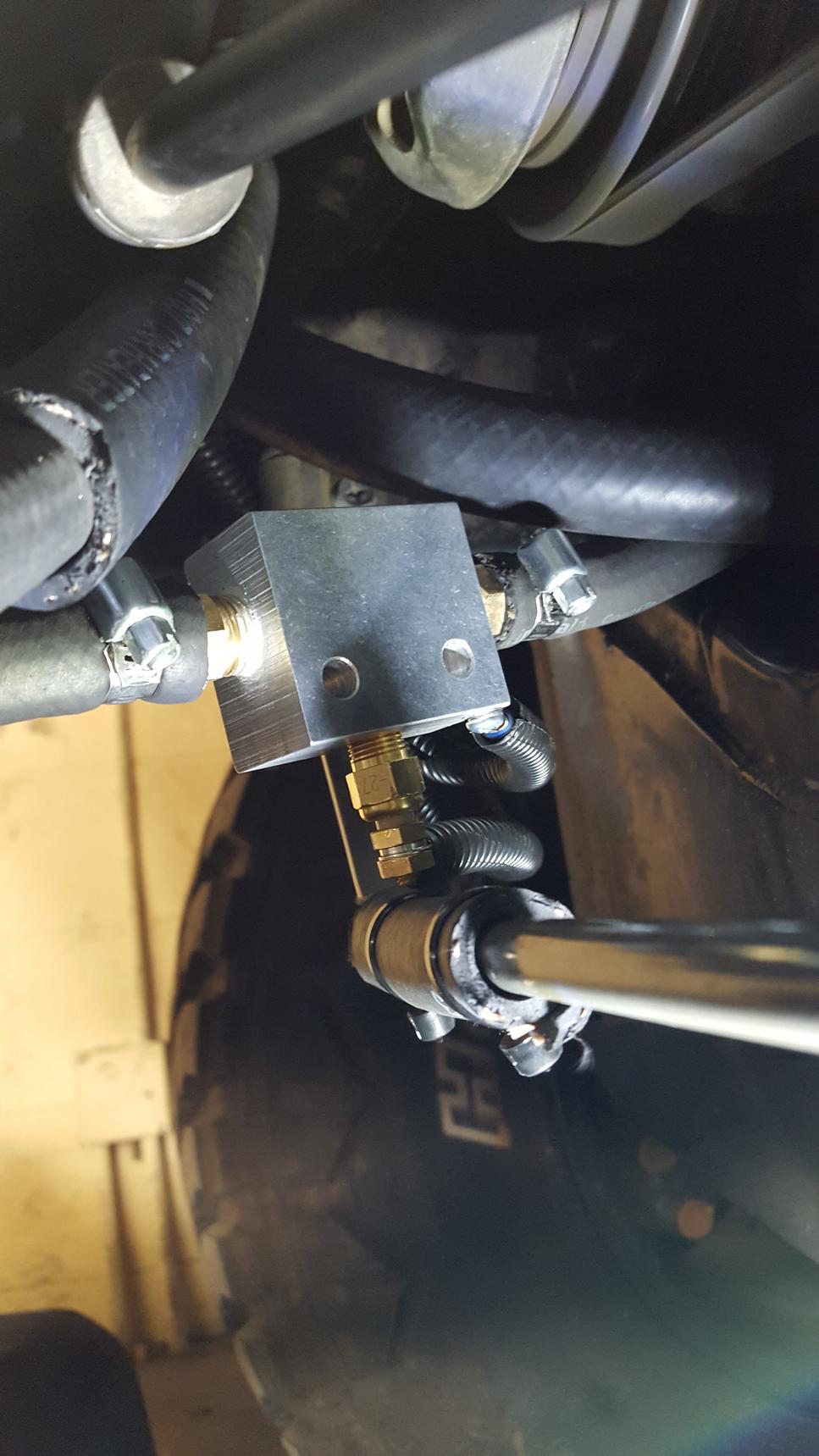

The install is straight forward from the directions you get with the gauge. If you decide to put the sensor "inline" the rubber hoses like I did then you need a sensor manifold like the one I got from Dakota Digital because it has a screw where you can add a ground, without the ground the sensor will not work. I placed the sensor between the line that comes out of the transmission to the radiator (passenger side) because this is the hottest point of the trans fluid. Others like to place theirs on the return side. Its personal preference. I chose this side because the 99-02 4runners have a built in temp sensor and that is where they placed it. 96-98s did not come with that sensor.
Besides buying the manifold (block) from Dakota Digital, you have to buy (2) brass fittings. The specs are 1/4" Male NPT to 3/8" Barbs. The fittings the manifold comes with are compression fittings for metal tubes. Other then that the Autometer temp gauge comes with the 1/8" brass sensor that screws into the manifold. That's pretty much it besides running basic wires and mounting the gauge. A lot of guys make their own manifolds from brass fittings you get from hardware stores but you still need a ground. For 35 bucks I just went with the Dakota Digital.

Thanks for that it seems straight forward after some reading
So just to be sure you bought the 3/8 sender block ?
Also where did you actually ground it to the body or part of the engine
Just trying to make sure I'm 100 percent certain about everything
Thanks for your help

Yes, I got the 3/8" sender block. I actually called Dakota Digital and they said I can get either because the threaded portion for both 5/16 and 3/8 is still 1/4" NPT. You are not going to be using those fittings anyways. Yes, you can ground it anywhere on body or frame. The shorter the ground the better. I found a screw for a metal mount for some tubes about 6 inches away and I just grounded it there.

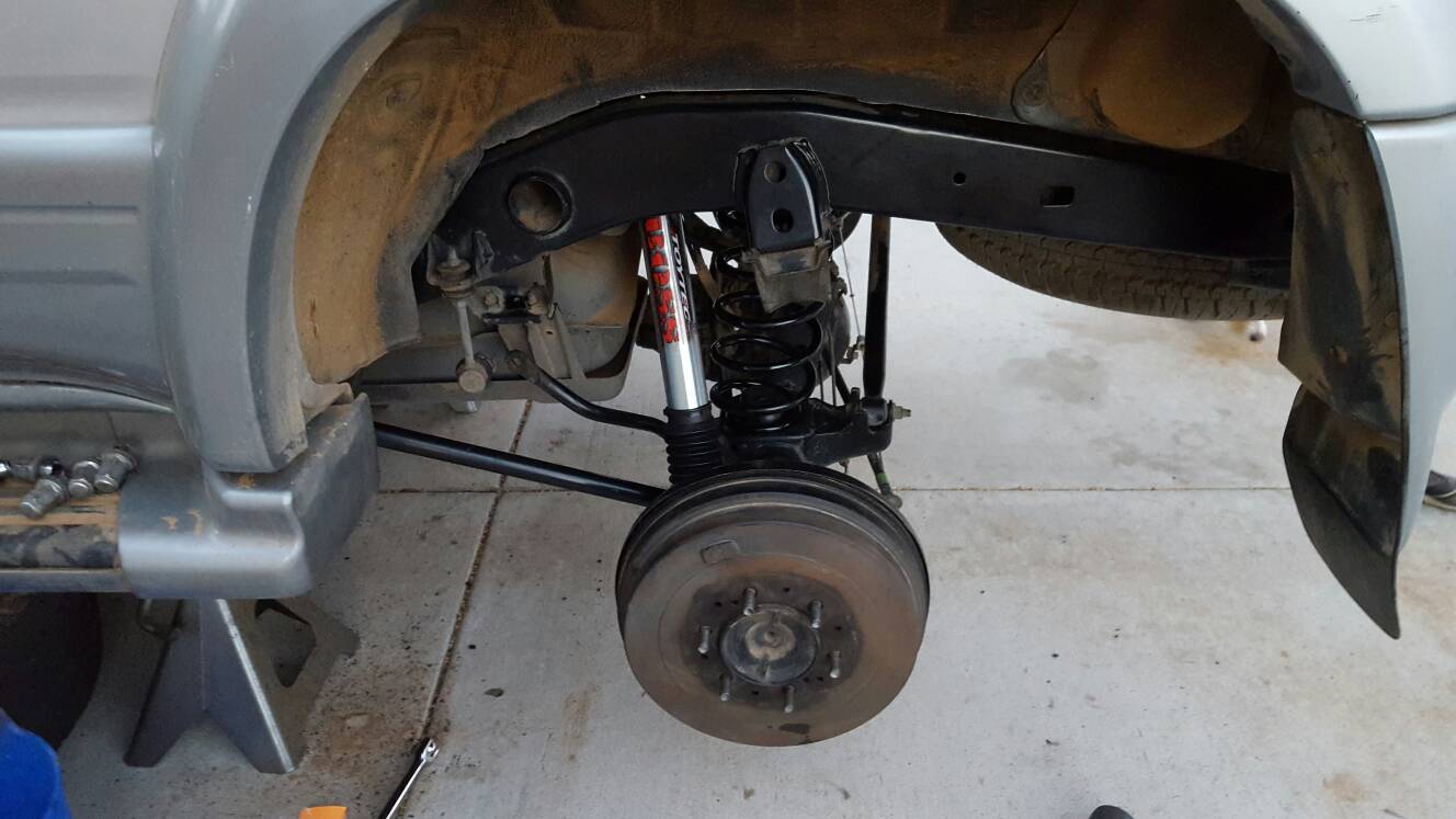

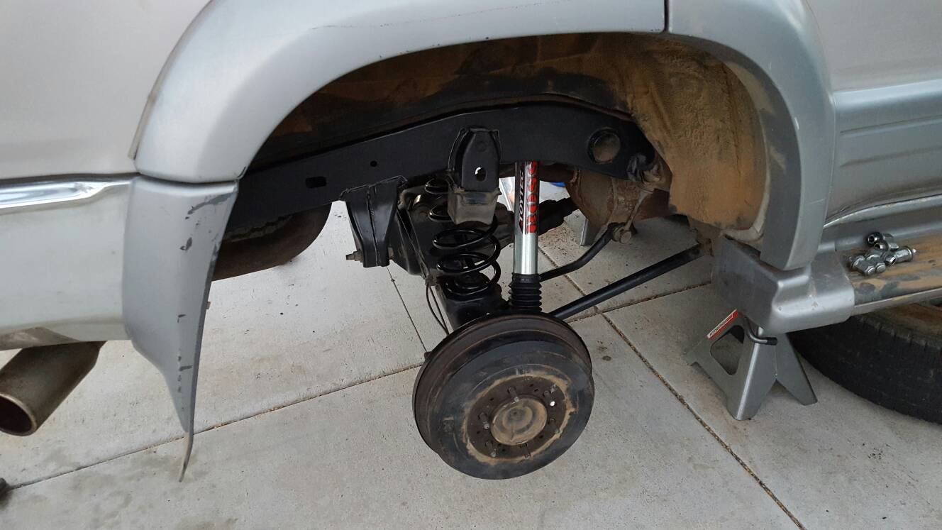

I also had to dig out my 10 pound sledge to manhandle the skid plate. It was thicker metal than I thought. Sprayed it black and put it on a while ago.
That's looking sweet Chris! A little pounding on that rear link and it's a spare! :zoom:
