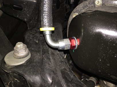

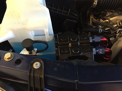

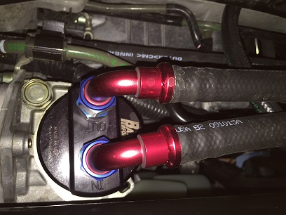

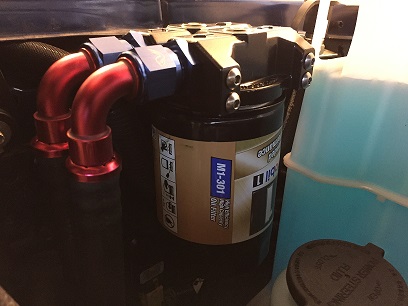

I installed a remote system on 5.7 Tundra. 300psi 5/8"ID internally braided hose with anodized AN fittings. Also, a remote sump drain with a quick disconnect hydraulic fitting that allows me to drain the oil via vacuum tank. No skid plates to remove and I'm good with that. But I have been modifying engines and related systems for a long time on both aircraft and cars, I'm comfortable with what I do, It's not for everyone.
