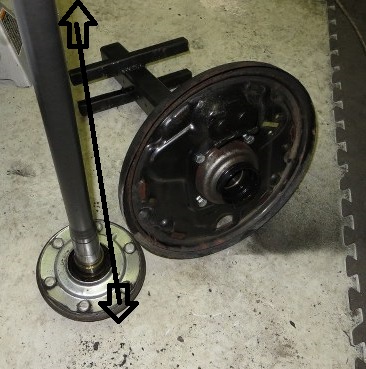

Can you please tell me how long is an axle (The brake drum mounting plate to the other end of the axle)? I plan on buying a press and in need of the length of the axle.
Also are you going to fix the axle now? You should be able to get a grade 9 or so bolt to replace it temporarily.
