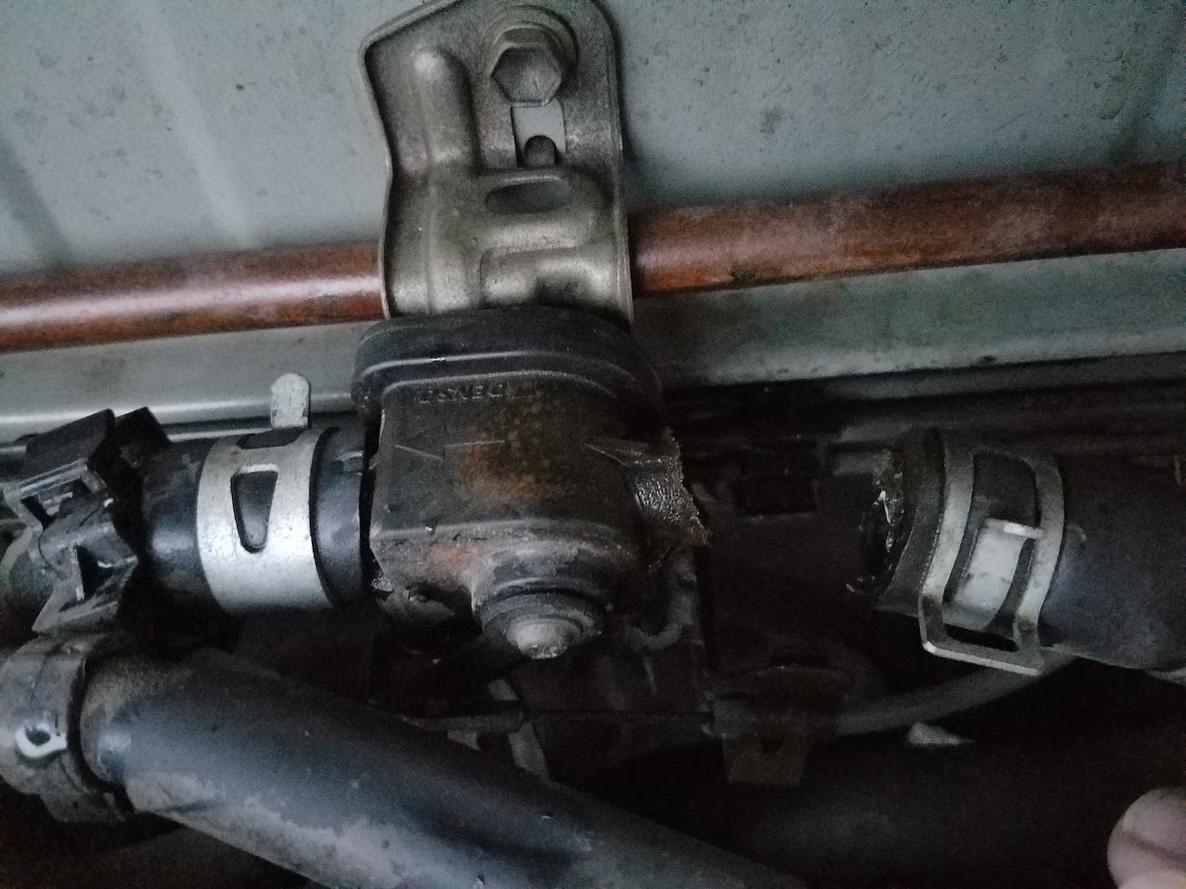

I have been loosing coolant with no obvious signs of a leak. Finally found evidence beneath the heater control valve. Got it warmed up to pressurize the system and verify. Sure enough it had a steady drip from the drivers side of the valve. I barely touch it and the damn thing let go and blasted me in the face with coolant! I ran into the house to rinse the poison out of my eyes and realize how lucky I am this didn't happen in the heat of summer and burn me as well.

Normal on all these older 4runner's. I hit the yard and all had same issue. It was my first NON OEM part I installed. Another member said there non OEM lasted 2 years.
Iv'e never heard anything about this on the forum. I didn't know what it was until now. Is there any other plastic parts like this I should be concerned with?
Mine broke in the same exact location a while back.... On the interstate doing 75 :shocked:
Mine broke at 12,200ft at the top of Wheelers Lake. It was freezing, but some duck tape and not using the heater held her together till I got back home. Ass puckered entire trip.

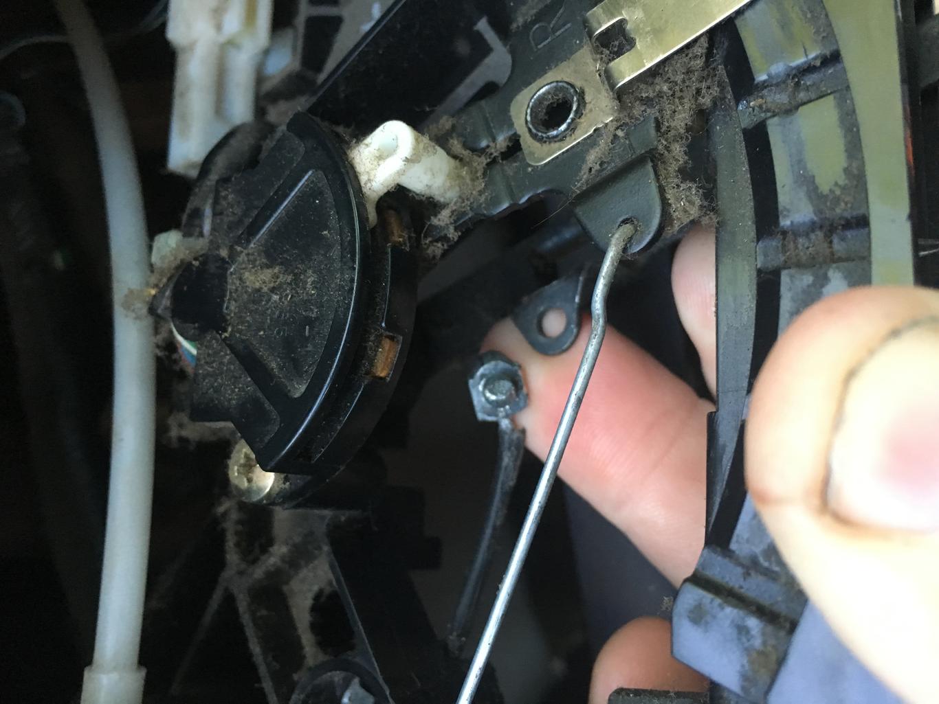

Messing with this now and when I put the cable in the clip holder, it's locked in place and won't move, what an.m I doing wrong?

That's normal
That's normal.

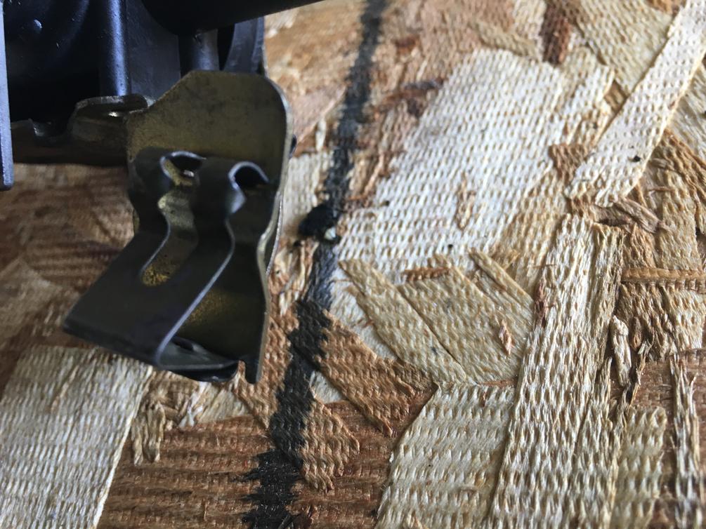

Well here is the problem I have with the cable. It won't stay secure in the hole.

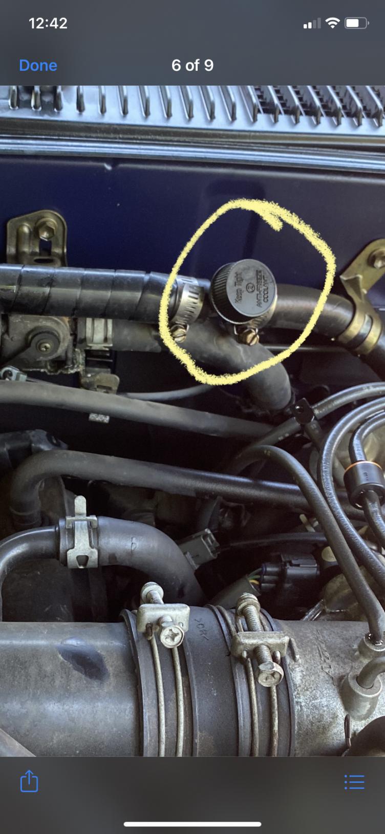

Reviving from the dead, just blew my Heater Control Valve to pieces, same break as everyone else, but I have another valve on the hose above it that also broke and looks like was leaking longterm down on the HCV. Any idea what it’s called? Perhaps it’s the (optional) return valve someone mentioned earlier in this post to keep the A/C cold? See attached photo and thanks for any help!!

That's not oem. That's part of a aftermarket coolant flush kit. Soposed to help in flushing the cooling system.
Some kits makes an adapter to connect a garden hose to aid in flushing.
