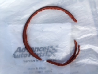

forgot to mention that when I took out the TS, I found red gasket looking material inside the housing. I cleaned it out, put in new OEM TS, gasket and then added the fluid and tested several time since then. Yesterday doing the very last bleed/burp with the rad cap off I saw another piece of that red gasket material right in the top of the rad opening. See pic. Thoughts on all of the above? Thanks again everyone.

Speaking of debris, it looks like a piece of red RTV. A first I thought it was mistakenly put around the thermostat housing and "pinched" off because someone got happy with the RTV. I'm going to give that someone isn't that stupid though because that area is sealed by an special oring around the edge of the TS. Now, another place that might have come from is someone got happy with the RTV when they installed a new WP and the excess pinched off inside. I read you said it never had one but this the most likely place that RTV would enter the cooling system as the other 3 places I mention would be much more unlikely. You could verify this by taking your upper TB cover off and looking for red RTV on the edges of the WP. One thing here though is that Toyota, from the factory, used a metal gasket with bonded sealant on it. BUT, many have confirmed that Toyota, FROM THE FACTORY, used red sealant on the WP. Mine wasn't like that, but just wanted you to know that, maybe there was some excess hanging on the inside seam, FROM THE FACTORY, and it finally let go. The only other places would be if some idiot tried to "seal" a leaking oring on the oil cooler instead of replacing the $5 oring and $2 bonded washer, or the water outlet on top of the TB cover. The common theme here is someone (maybe even a Toyota line assemblyman) got happy with some RTV somewhere and it "might" be clogging the passage ways in your radiator and heater core.

The red gasket maker RTV should not be there, someone has been into it.

JRZ-I do recall when the TS housing was off, seeing a bit of the same red material squishing thru a bit from whatever the housing bolts to. But there was only the black gasket on the TS, as it should be.

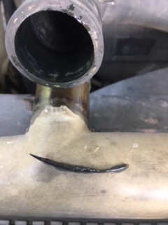

UPDATE: In preparation to do the flush, I pulled off the top rad hose and just inside the hose found this black gasket piece. Does this change any of my testing or just proceed as planned?
No, doesn't change anything. Is that a shaved of piece of a large oring or does it seem like more RTV of the black variety? Helps to be able to possibly identify what it is then maybe where it might be coming from so we can narrow down what maybe be going on in your cooling system. Lot of maybes and possiblys there. Sorry about that but you have a bit of a mystery right now.

JZ, it looks shaved and not sure if its RTV or Oring. How can I determine the diff?
