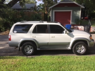

After a month she's back on the road. I live in St Pete and I still came out cheaper to have a flatbed take her to Tallahassee for repair than have it done here!
Ahh but why was she overheating...? The water pump was completely locked up. The idler pulley was purple it got so hot too. I had never seen that before..it was quite interesting.
My guy in Tallahassee installed rad, TB, WP, Therm, pulleys and all the other stuff that came in the kit, in addition to drive belts and lower ball joints. I asked him to do the brakes too but he said they were good. I bought the parts- all OEM- and had them shipped to him and he installed everything..for $900, in case any one was wondering.
I just ordered new plugs and wires which I'll replace once they arrive.
After I got her back and was cruising around town, she turned 192k miles. She has never left me stranded, not even this situation. I had just parked in my driveway, smelled something, popped the hood and saw coolant everywhere...and then this -month long- hunt for why she was overheating began. I'll always have this truck and always take BETTER care of her!
Thanks for everyone's help here. Esp JRZ! IT is all appreciated!
