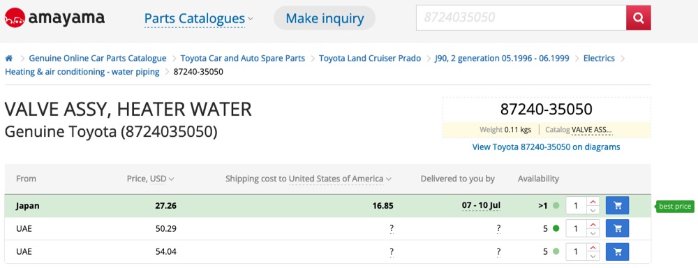

FWIW I was just looking for the heater control valve for my '96. It's about $75 with shipping from Partsouq but Amayama has it for about $45. If you're not in a hurry, of course.
I’ve been ordering a lot of parts from amayama lately. It takes me a couple weeks to find time to install them so what’s a little more time waiting for them to arrive? Lol
