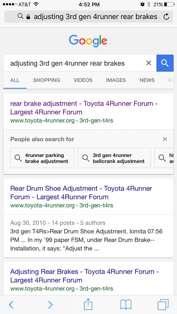

As far as adjusting the rear brakes- I am not sure. Have you Googled it?
Lots of info-
