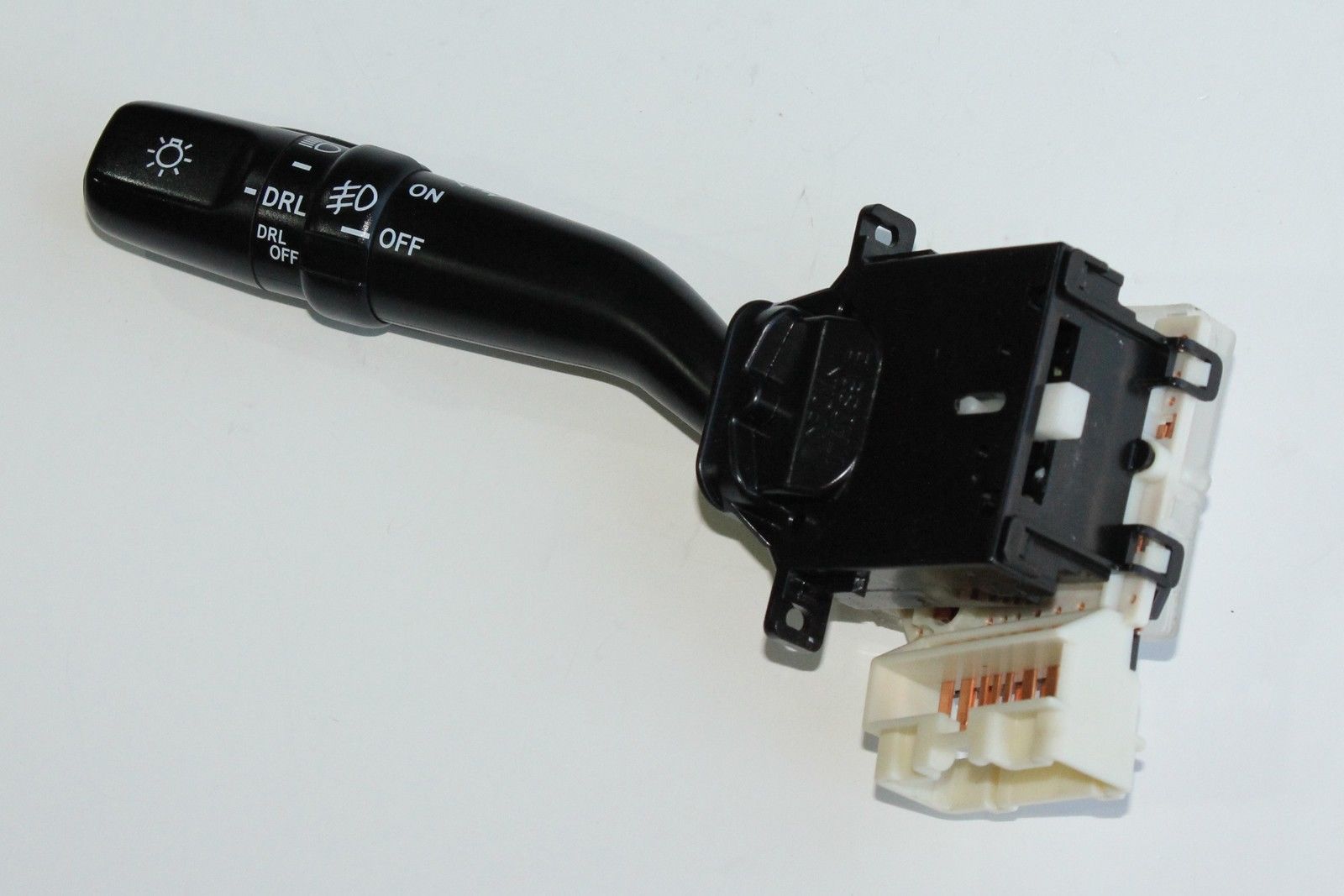

velomatt Member Mar 9, 2014 #1 Anyone try know if a headlight stalk switch that has the DRL OFF setting will work on an 01-02 runner? (this is for a 01-03 Solara) Attachments $T2eC16hHJI!E9qSO-ShmBRSmWHbKrg~~60_57.JPG 109.2 KB · Views: 2,502

infamousRNR Senior Member Aug 26, 2017 #2 velomatt said: Anyone try know if a headlight stalk switch that has the DRL OFF setting will work on an 01-02 runner? (this is for a 01-03 Solara) Click to expand... this looks to be the correct stalk, however its not simple plug n' play... there is a write up around here for the wiring but photo bucket is causing me to scream photo-phuckit... i just snagged one from a 99-01 es300 that looks identical. I hope more people chime in on this topic.

96RedRunner Senior Member Aug 27, 2017 #3 I ebayed a 99-03 Solara stalk that wouldn't fit the column mount. 99-01 have part number, 02-03 have dif part number. DRL mod 2.0 shows it can be done, up in the air about what stalk to use.
