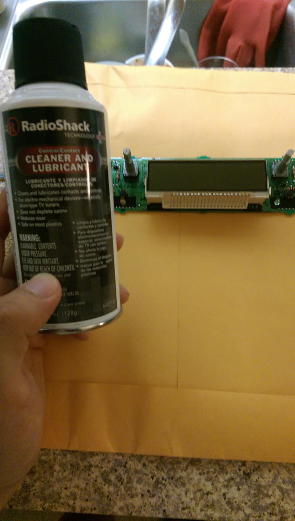

The knobs are easy to fix. Some tuner cleaner from RadioShack fixes those. Now for the buttons. It's a little more complicated. I paid $320 to DAC one of those outfits that sends you one without having to send one in first). Then you get $100 back when they receive your old one. I had already tried repairing my original one. Replaced some buttons thinking they were the problem. They are not. When I got the replacement, I found out that the one you send back cannot be tampered with in any way, which mine obviously was. So I wasn't going to get my $100. Anyways, I have a degree in Electronics so I decided what the hell, I'll take apart the replacement and see what they did. Maybe replaced the potentiometers for the fan and temp controls. The new controller's potentiometers didn't work well at all (not responding to turning, skipping settings) Tuner cleaner cured that and they've been working for 6 months now.

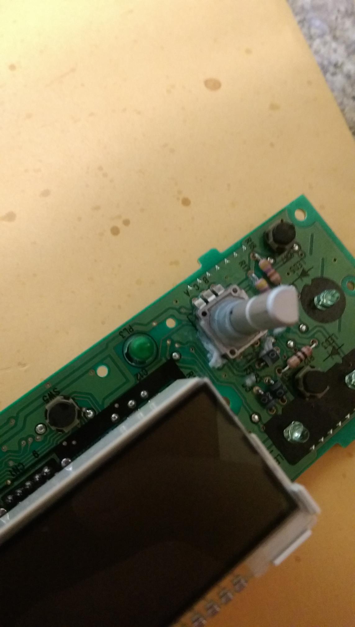

I can also tell they removed the LCD. All the button SMD resistors and some diodes are under there as another member pointed out. Also spotted an IC chip which definitely had some suspect solder connections on it. Most of the solder connections are so small you need an eye loupe to really see. I was successful in getting my defroster button to work but in the process for whatever reason could not get the AUTO, TEMP or RECIRC buttons to work anymore. I gave up because I knew I needed some more sophisticated soldering/ desoldering equipment that I don't have. I'm sure all the problems are under that LCD specifically that IC chip and those SMD resistors and arrays. I've been eyeing a solder station to do the job but it's over $500. I still have the Digital AC unit in a box. Might have to get back at it, although I think I may have accidentally lifted one of the traces from the PCB. (wrong tools for the job, maybe the reason why those button don't work) This seems to be a big problem that needs some resolution. Anybody have a spare I can fix? Once I get the new station. I'll do it for free and post the results.
Perfect. I'll try cleaning them with tuner cleaner this week and report back. Thanks!
Pull the knobs off and very lightly spray the tuner cleaner down on the shaft down into the body of the potentiometer. Turn the shaft back and forth a few revolutions and repeat. This process is a little better and a little less messy if the circuit board is out (or at least the climate control itself standing vertical) and laying flat so the cleaner flows down into the body instead of more out and into the bottom of the climate control housing.
Quick Update: I took the advise from the forum and purchased me a small bottle of tuner cleaner from Radio Shack. Costed me about $10. After taking my climate control apart, I sprayed the tuner cleaner around the climate control knob. Now the issue I originally had where the the digital temperature only ranged from COLD to 72 degrees is gone. You can really feel each gears as you turn the knob. Sometimes you realize common things like getting hot air on newer cars for granted. I'm really excited I now get hot air. :guitar3:

Actually the board sees heat cycles from the small "condomed" bulbs that are in there, and they get quite hot....
As has been mentioned here, if you flex the board you can get it to work sometimes, which is why some people have success by simply pulling it apart and then putting back together again - for a time.
And the flex itself implies that some of the solder joints are bad, which has indeed been the case for all the ones I've seen (and repaired...).
I have never seen bad buttons or pots though I guess if you live in a very dirty/corrosive environment it's possible.
You can very carefully bend up the lcd display from the main board as I have mentioned without desoldering it. Don't do that too many times though, the leads will eventually break. I believe the small resistor arrays may get extra heat under the lcd screen possibly. Seems to be the general problem area anyway.
