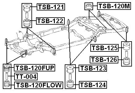

I've been replacing them with the febest brand and they have been working out great. Its much cheaper then going oem those are the pn# just add febest and there sold on ebay too
I replaced the upper part (part the weight sits on) of my front most two body mounts with febest when installed the body lift to replace the compressed stock ones. About a year later I noticed one of the febest mounts had split at the parting line. I replaced it back with OEM. The other side febest mount is still fine so maybe fluke but just a watch out.
I pretty much did the same thing I related the lower one cause i got lazy doing the BMC mod. So i replaced just the lower one cause i scorched it a little. i noticed it wasn't even contacting the frame cause the upper was to compressed. i think because the spindle between them doesn't let you really torque them down. I replaced all of them and a lot of my squeaks went away and body roll. these trucks are over 10 years old. the febest is a lot stiffer then the oem ones.
