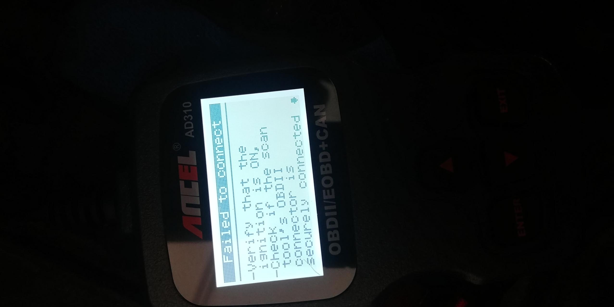

My scan tool arrived.. It continues to fail to connect. Schweet...
So ran through all the fuses again.
Tried 3 scanners and none would communicate with my OBD port. I confirmed they work on another vehicle.
Pull the ECM and checked all the connections and visual of wiring. Pulled the ecu fuses to confirm them.
Everything still powers up, engine turns over like a champ and all electrics work.
Still no spark and no go go.

Based on the fact you dont have spark and can not communicate with scan tools it's for sure an electrical problem. Be sure you checked all fuses, under hood and under dash panels as there are multiple fuses that feed power to ecm/pcm. Otherwise I'd have to find a schematic and see what all is included in the ignition schematic. Not sure if it has an ignitor like some Nissan systems or if the ignition coils are driven by the pcm. A little background I'm a 15 year Honda master technician, but my Toyota experience is very little.
Don't mean to beat a dead horse, but when you "ran through all the fuses", like the OBD and ECU ones, you put a meter on them?

I'm capable to a degree but since I hit this OBD issue i'm stuck.....
I've pulled every fuse at this point for visual as well as testing with a meter and swapped relays, there are some fusible links but when I turn the key everything powers up and the starter cranks hard so those I would think would be a non issue.
