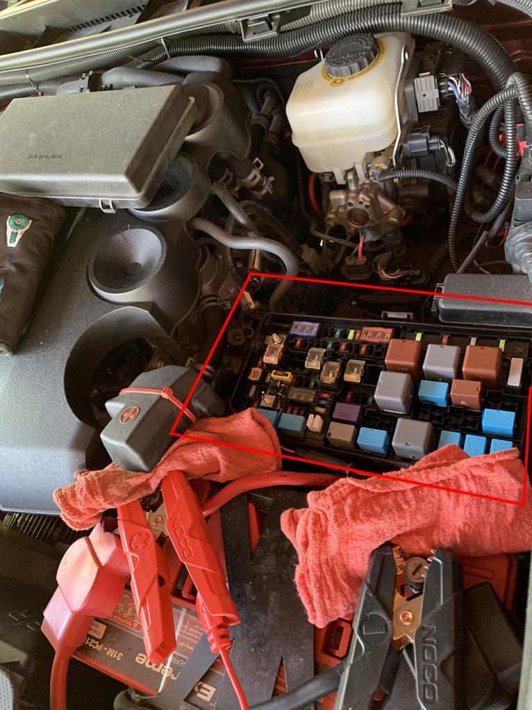

*** SOLVED***!!!Filled up to the "click" drove 80ft and it died. No Spark!

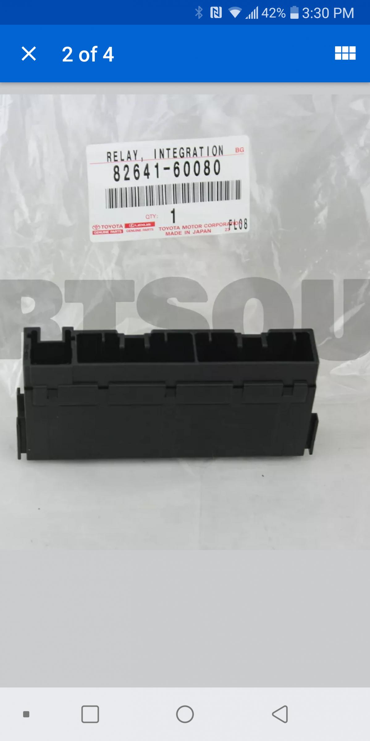

So this is the relay....and why i assume they call it integration relay because there are fuses stuck in the top of it. I never would have known it was a Relay too.

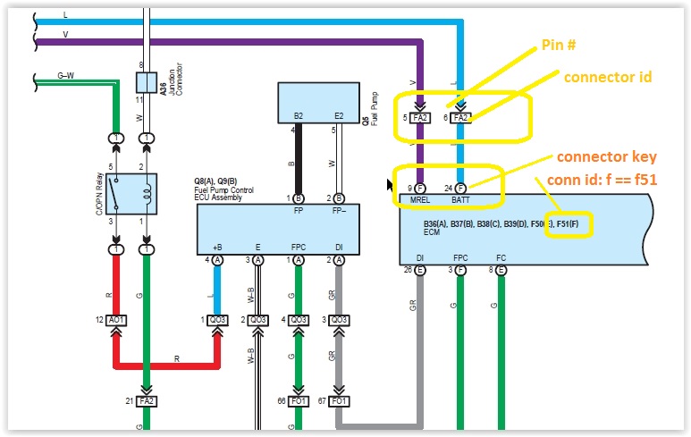

337764d1561698002-filled-up-click-drove-80ft-died-no-spark-101_1-jpg
That Violet wire on pin 9 of the ECM leads to the EFI Main relay which is part of the Integration Relay (AKA Unit K).
I've heard of this unit failing with only the horn as a symptom; almost always associated with overloading by aftermarket horns. Never heard of it killing the whole shebang.

I mentioned it earlier, anything in the fusebox, other than the block relays and blade fuses, you pretty much have to remove the fuse box and pull the components out from the bottom. It's pretty ridiculous.

The integration relay (unit K) in the diagrams is an exception. This little magic box is lifted out with all of the connectors attached and has enough spare wire to pull clear of obstructions.
As to relationship between aftermarket horns and this relay unit; If the horns are powered via an aftermarket relay and the stock one only switches the add-on relay I can't see any logical path to failure. However, if aftermarket horns are driven directly by the Unit K relay then who knows how they fail, but they do.
The internals of Unit K are a mystery, but I assume there is a circuit board with magic smoke devices and at least 4 standard coil relays. A mechanical horn produces it's sound by rapidly making and breaking contact on a magnetic coil so I can find some logic to them over-driving an IC that was designed for a lighter load.
