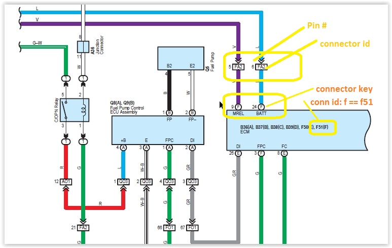

I'm having trouble placing remote images in the post so everything will be 'Attached'.
Here is a link to the entire 2010 wiring diagram set.
You will find that it can be difficult to locate a specific area or component by file names. I use windows explorer to search (Ctrl F) within the folder to find the right file sometimes.
The last attachment shows the main power feeds to the ECM.

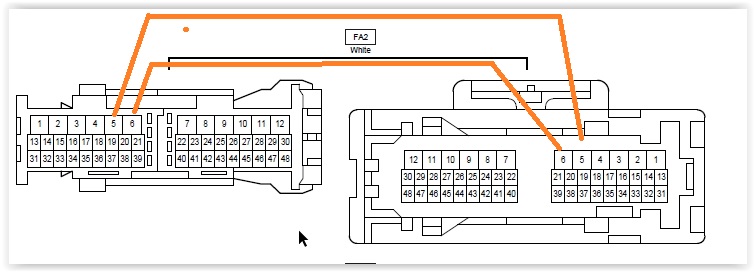

first a Toyota wiring diagram refresher in the first 3
The connections are displayed as a box for pass thru connector to connector. The ID is in the box- FA2 in this example. The pin number is beside it.
Connector to an item (ECM in this case) are shown as circles with the Connector key in the circle (the key is a single character) Somewhere on the diagram the key will show the connector ID. In this case F equates to ID F51.
The last pages of each diagram set (pdf file) will show the connectors.
*Edit* !! The images show a face view. When back-probing you have think in a mirror image. Left is Right when viewed from the wire side.
As you search for connectors in the files you will find that sometimes item F51 will be F 51 in other locations. Spaces count for seach…..

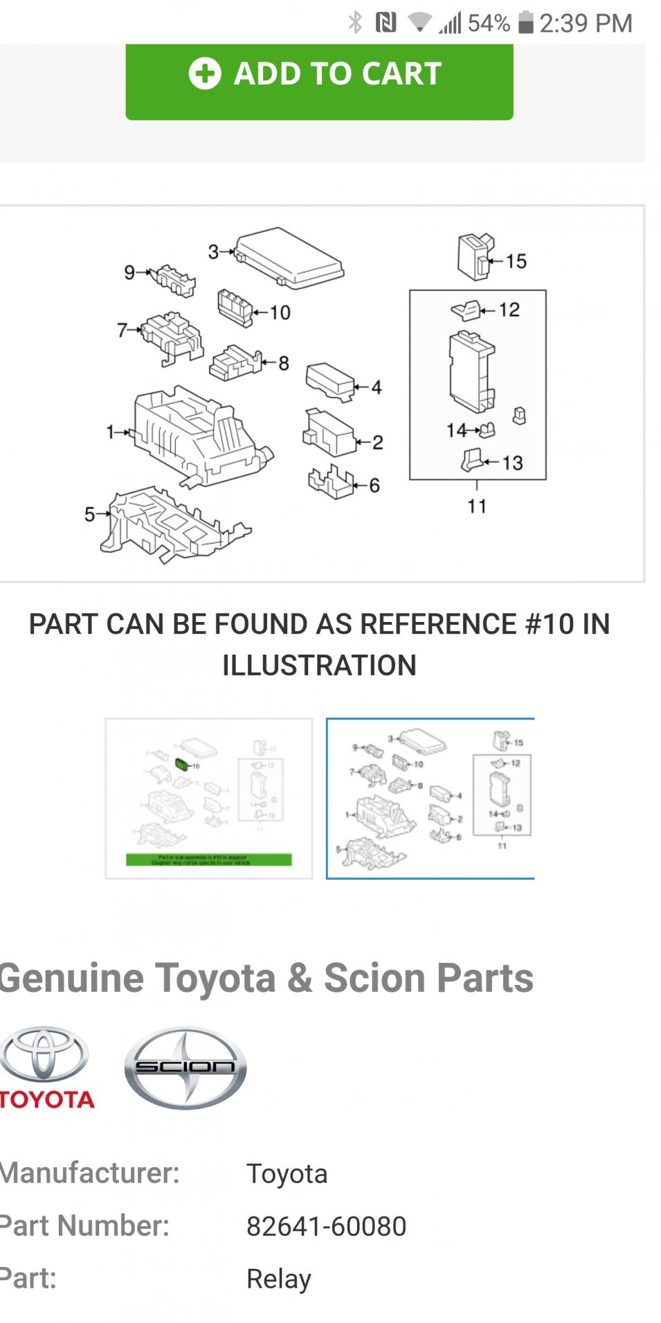

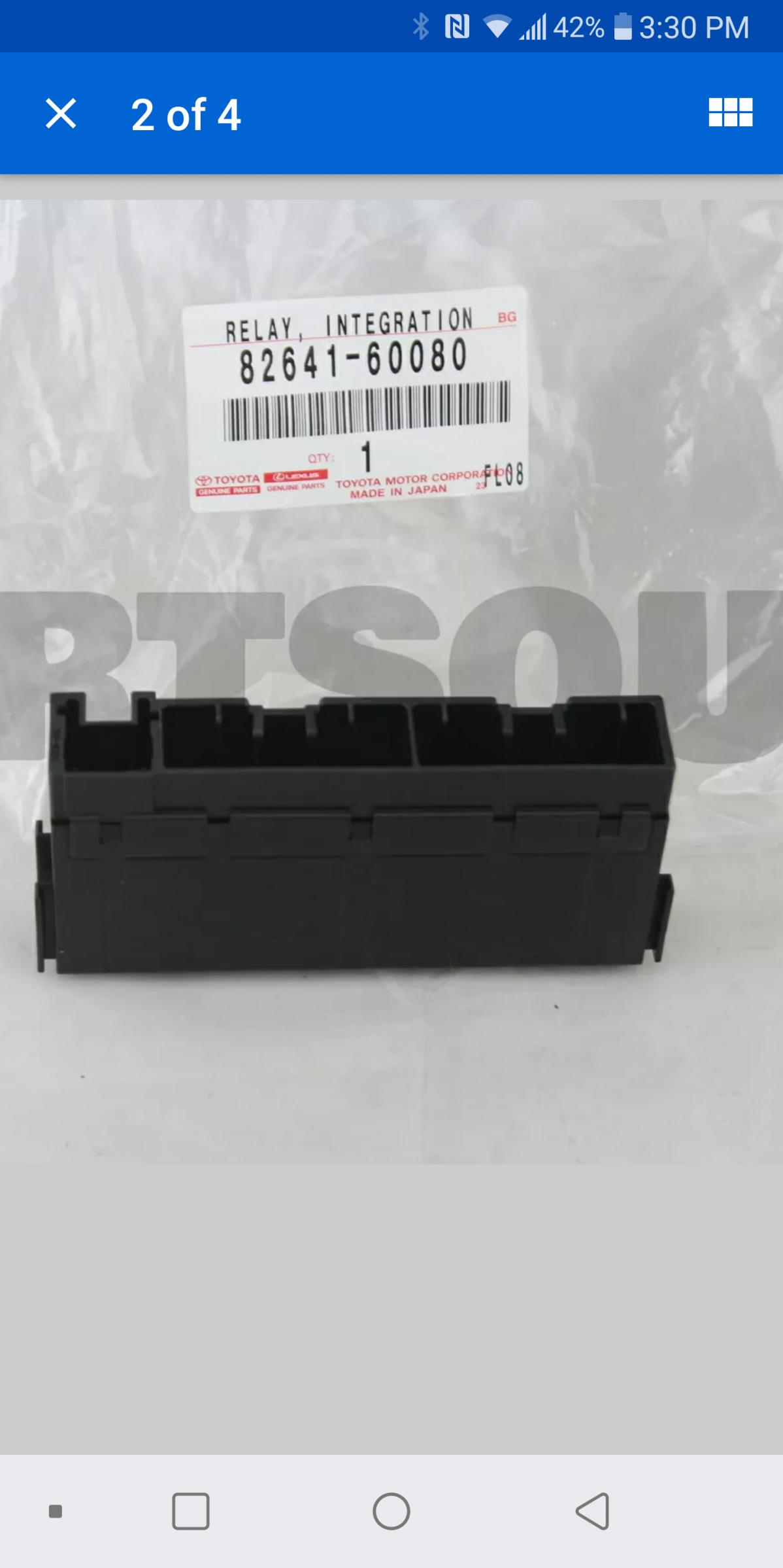

Turned out that it was a Relay that i have no idea where it's located.
The relay #82641-60080 was 200$ and the diagnosis time/labor was 2.5hrs
Where is this and what is its job?
Part # 10 in the diagram
That looks like the engine compartment fuse block.
That blows, if that sh!t went out in the middle of nowhere...
That is nearly as bad as the alternator fuse in the same box, you have to gut the entire thing to replace it, out the bottom! or pull an [MENTION=65614]Antman[/MENTION] and rebridge it.
Where about in the engine bay? Firewall?
