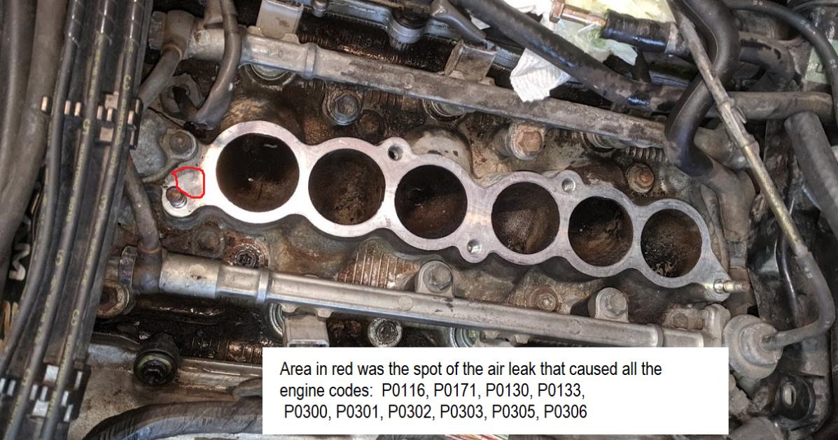

As the engine is running I started spraying carb cleaner around the vacuum hoses and intake, and near the front of the intake on the bottom, I could hear a RPM increase.

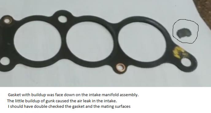

This morning I pulled of the intake, and noticed on the bottom of the lower gasket there was a small 1/4" roundish buildup of smudge, that almost looked like compressed graphite. I cleaned up (again) all 4 mating surfaces of the intake system, put in new gaskets (again, but this time I tried the fel-pro brand), the previous new gasket was LIMICAR brand.
I put everything back together, hit the key and it started right up and idles like it should. Went out for a 10 mile test ride, and it runs great! No idle issue, no engine codes, will idle at 750 RPM just fine.
Thinking about the issue with the air leak in the lower part of the intake it all makes sense.
When at a low RPM, below 1500, Too much air was getting into the engine causing random misfires on each cylinder and also other engine codes including the P0171 system too lean Bank 1. At a higher RPM the small amount of air sneaking in was not enough to affect the larger volume air entering the engine.

I had all these codes all because of the intake leak:

Attached are pictures of the offending issue:
-andy

I agree OEM is always the best choice, unfortunately I was in a time crunch (or thought I was). The gasket I put on probably would have been OK if:
1: I had double checked it for flaws.
2: Double checked the mating surfaces to make sure they were clean.
I still don't know if it was the gasket or my poor preparation of the intake, either way I should have double checked first, lesson learned.
