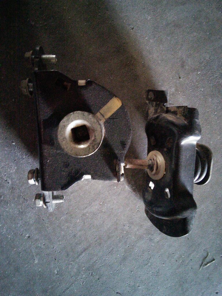

You mean one of these.
This one hasn't gotten thrown away yet, I'm surprised.
Would you be interested in selling that spare tire hoist? Assuming it works of course...The cable on mine recently broke and I would really rather have a spare tire than not.
