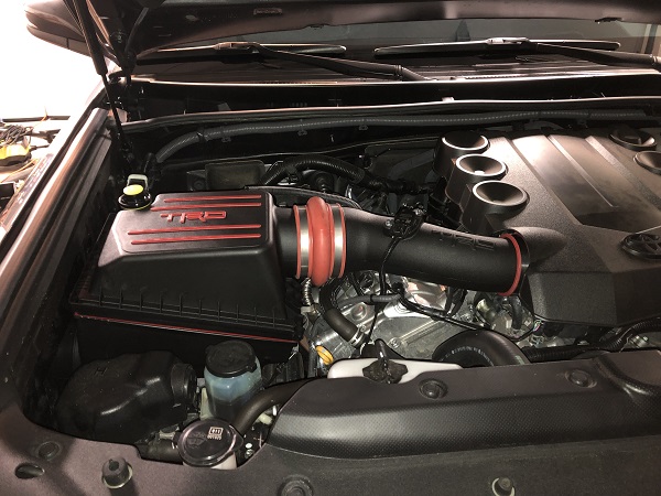

Installed the intake I received today from the TRD sale, fairly easy and did it myself in a few hours. Something I'm glad I caught however was a manufacturing defect in one of the couplers. The coupler that also connects to (i think the vacuum) tubing had a very small film of rubber on the inside where there was supposed to be a hole. Very easy fix with a knife or scissors, but would have been a complete pain if I hadn't noticed it.
The thin film was on the inside of these 2 holes
thanks for the catch. waiting for mines to arrive and will definitely make the adjustment. so just to be sure, you removed the small film of rubber, correct?
Also make sure the coupler from the pipe to the airbox is on there tight..
While revving hard (i.e. sand pulls), the engine tilts quite a bit and can pull the coupler off and risk pulling dust into the manifold
Mine was good.
If you guys are wondering what to do with the wire harness, here are some pics of what I did to reroute it.
In the last pic, I snapped the leg off the clip that was on the original airbox, then noticed there was a long flat clip taped further up the wire bundle towards the fender, so I just cut the tape and moved it so I could use it to attach the wire bundle to the new airbox.
