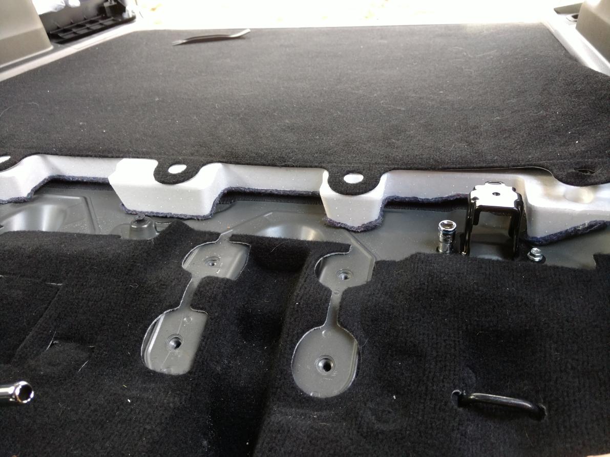

Just ripped out the back seats, gonna pull everything back there and put down some roadkill and then a layer of raammat ensolite over it. I noticed there is a ton of foam and rug crap already down. My question is can I fit the layer of road kill and the layer of ensolite underneath it and still tuck my carpets back in.

I have a 5th gen, but this seems to be the only thread allowed for these things, should I post in that section also?
