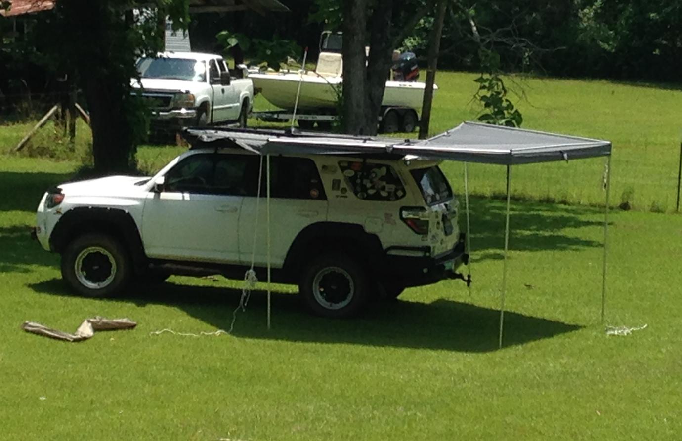

You are aware the Batwing will not allow you to open your rear hatch when it is deployed don't you? I've wanted one for years, but just could not justify losing the ability to have full access to the back of the 4R.

I don’t know that this is true. I’ve seen pics where they raised that rear section of the batwing and then opened the rear hatch under it. Not ideal, but from what I saw it was doable. But honestly, I don’t see the point. If your going to open the hatch under the batwing, why get a batwing? Just open the hatch and use a standard awning.
Oh it's doable. But you'd be lucky to get the hatch open more than halfway before you hit the awning bar. I got this at Jambo knowing I was mounting it on my trailer. I already had it half bolted on the 4Runner so I just installed the other bracket and opened it to see what it was like. Raising the awning is one fix, but you'd have to raise it 8 or more inches to get all of the hatch opening, with the attendant potential for snagging it in a tree on trails. And the SSO rack sits lower so it aggravates the problem. Hence my normal ARB 2500.

Well, that explains that.

Thanks for the info but is moving that portion or the awning to open the hatch that difficult once deployed?

I honestly can't say for sure. Mine is NOT a Foxwing, just that style. Mine has tube braces between the ribs for support while the Foxwing, and I assume the Batwing, both use a strap to the rack for tension. I know mine kept collapsing until I got the upper bracing in. I had to walk them around one at a time as I added the upper pieces. The Foxwing doesn't have legs IIRC, so it might be as simple as just removing the tensioning strap and swinging the last 2 ribs around for clearance. That's just additional work I was not willing to do to gain access.
