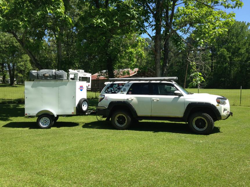

This is what I did for my trailer setup. I have 2 crossbars attached to the RTT that are exactly spaced so all I have to do is remove 12 bolts, move the tent to the SSO rack, and install the 12 bolts again. I'm using 24" centers on the 2 crossbars and the tent will still be resting on 2 middle and 2 outer bars in addition to the ones it is bolted to. I will just leave those 2 positions open on the SSO rack when I am trailering the RTT. I did use shorter bolts than my Tepui came with because I was afraid the longer bolts would contact the roof below the crossbars. You just need about 1 3/4" to 2" below your CVT bars to clear the 1" thickness of the SSO crossbars and have room for the bottom clamp plate and nuts.
I did loosen all the crossbar to side rail bolts so I could spread the side rails slightly while dropping the tent onto the rack.This method also makes it easier to mount the RTT because the tent will be resting on other crossbars while you are lining up the holes. Let us know if this helped.

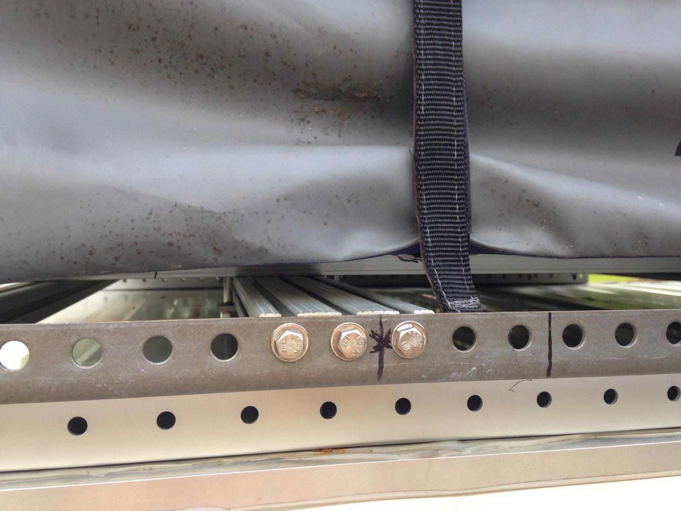

I wish I was closer so I could be more helpful. I know saying it and simply describing it can be lost in translation. Here is a closeup of one of my crossbars and the attachment to the tent rail if it helps. This is on the trailer, but it's the same concept. You can see how it sits on the crossbar forward of the mounting point to the left, so if you can do it without spacers you won't need to hold the tent up while you start the screws. The other crossbars on the rack will support it while you get it positioned properly. I really hope you can do it without spacers because then the RTT will be supported the full length of the tent rails.
