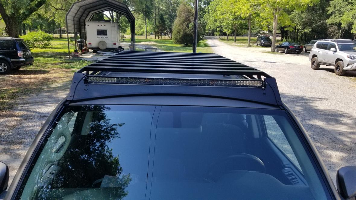

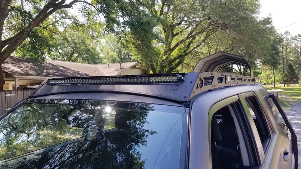

Received my SSO rack yesterday and installed today.
NOTE: I also have the issue with the last crossbar. 2017 TRD OR.
I don't remember if I requested for the SSO badge to be painted but I'm glad it was when I received it. Planned on painting it black also.
Mostly everything bolted up fine. I did however need to oval out the three holes for the wind deflector bracket. No biggie.
Did the install myself which took around an hour and half.
Few pics of the intall:

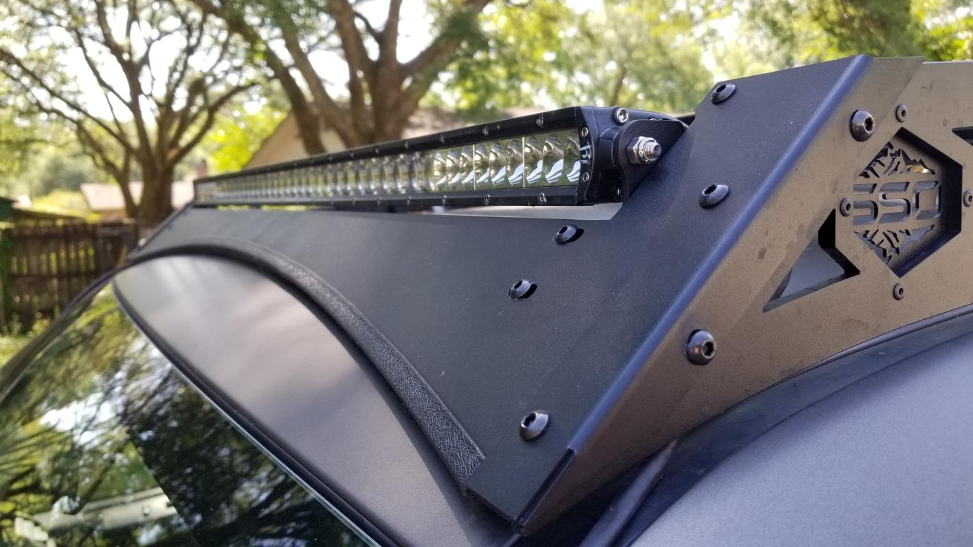

nice install pics. I have 2 questions.
What's that clear gel around the bolt areas?
What visors are you rocking? Looks super clean and seamless!

Silicon to keep any water from going between the standoff spacers and the gutter down into the headliner.

Some more pics of the 40" lightbar wind fairing for the SSO rack. This is the Rigid SR2 40", but it also accepts the Baja Designs S8 40" and the Heise single row 40".
