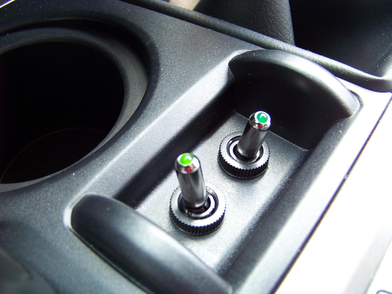

This is what I use. You can mount them anywhere. They look good. And they're tiny. You'll have to label them or just remember what they do.
If you have an aftermarket radio, you can mount at least 8 if not 10 of them on the sides of your radio.
ORACLE Flush LED Illuminated Ring Switch
Thanks for posting this link, I actually looked through your build the other day because I remembered those switches, I might use some of these. The only issue is how to label them...I might come up with something.

This is an idea that I like. Unfortunately, I have a LTD so I have a 120V outlet there, so at most I could fit 2, maybe 3 (see picture).
