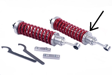

OK, here is the difference:
The coil-overs with the red coils have a threaded coil lift adjuster that simply requires being turned with the Toytec supplied spanner:
The silver coil-overs that you referenced use a "C" clip to adjust the strut, which is, apparently, more difficult.
