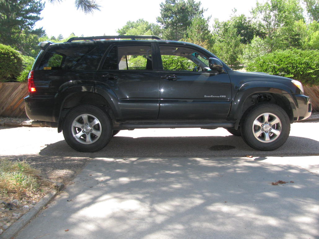

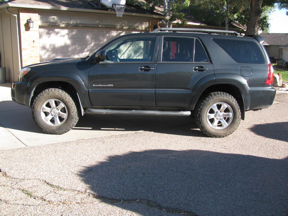

Here are two pics, both after the Daystar lift. The first is with the old 265/65/17 tires, and the second is with my current 255/75/17 BFG KO2's. I'm pretty happy with how the lift came out.
