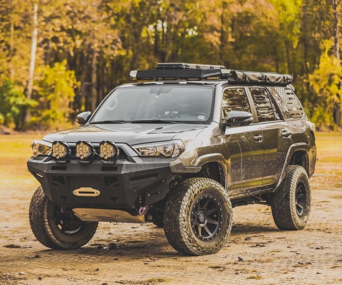

I am getting a 2020 TRDP after selling my 2016 Taco TRDOR. My Taco had a 3 inch lift kit with 275/70/17 KO2s and had a great look. I would like to see my 4Runner look as aggressive. I don't necessarily want to replace the FOX suspension to get the lift, and the parts and accessories guy recommended adding a 2 inch lift with spacers. The ride will be a bit stiffer but otherwise should be good to go. I would love to hear your opinions.
Top plate spacers won't change the ride but as with all top plate spacers, you have the possibility of bottoming out and bending the coilovers. Less so with smaller spacers but it can still happen.

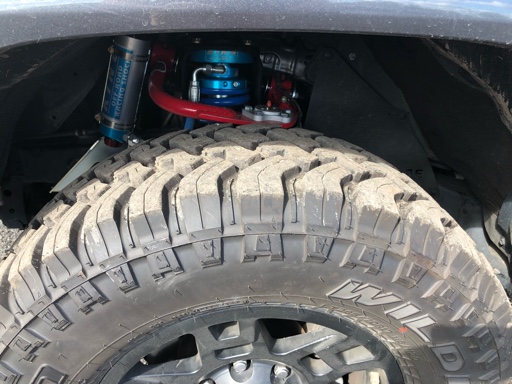

Not an answer thats 100% complete since nothing is installed (and truck only arrived at the dealer today) but what I ordered is the Eibach 1" lift rear coil and 2" front cornfed spacer. I plan on going to the front Eibach lift coils when they are released for a simple lift that still works with the stock Fox.
Main reason I did this was to fit my upgraded wheels & tires a bit better. (18x9, 0 offset) and 285/65/18 tires.
