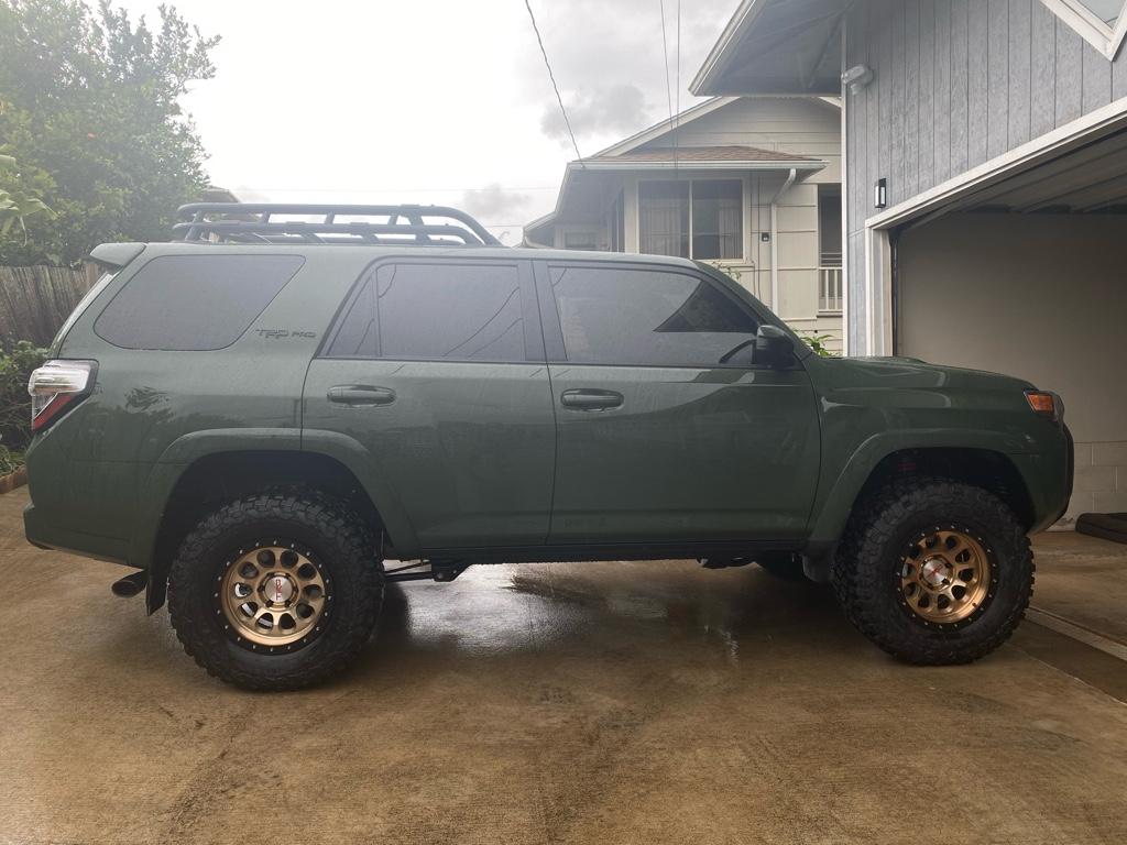

Running spidetrax spacers and a 2.5ish lift.

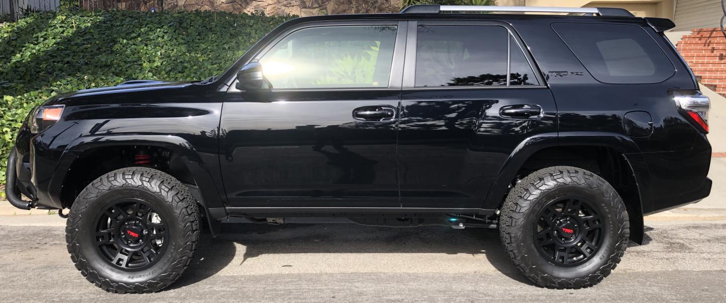

I did Burtman Industries 1.5”/1” spacer lift on my Pro and I really like it. I have 275 KO2’s and fully articulated off road there is no contact. Spacers will create a rubbing problem. I did not want to remove my mud flaps or make any other modifications. Fender liner mod is already done on the Pro. With the combination of the E rated tire and the spacers, it does ride slightly rougher. I have been running this setup for 15 months without issue. It was only $400 for the spacers, installation and alignment. I personally like the look of the Pro wheels and the offset offers no problems clearing the UCA’s and the body mount.

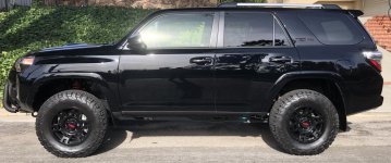

I ended up going with Burtman Industires becasue they are the exact same quality and material as Cornfed, but offered more sizes. I went with 2.5/2". The ride is just a little more firm than I prefer, but I got the look I wanted and fit the tires I wanted, so I'm happy and would do it again.
That looks nice!
