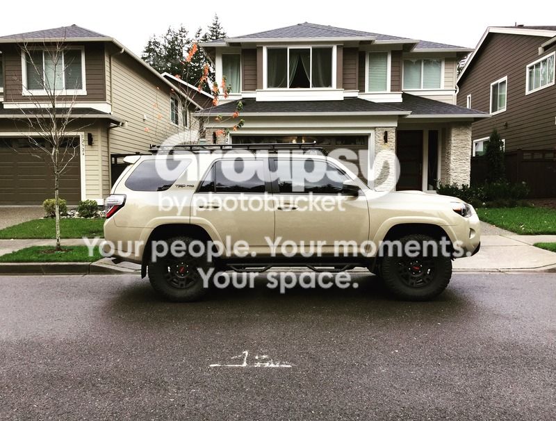

IMG_3661.jpg~original
This pic is after adding 1.5 inch wheel spacers. I had to modify the front liners and trim more bumper, but it now it slightly rubs on the body mount.
