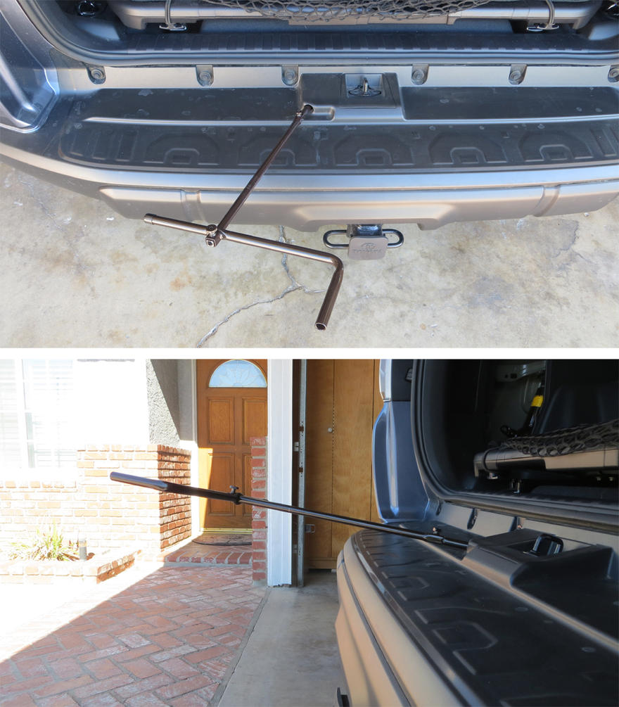

I tired and failed a few times to learn how to let the spare time down. The manual does not show clearly that the tool needs to go in at an angle. I would guess that it needs to be about 30 degrees toward the driver side and up about 15 degrees. Glad I figured this out before I needed it on a trip. I think someone in Japan must have had some bad fish the day this was designed.
The manual also says to mount the spare with the road side up. This makes the valve stem inaccessible to check the tire pressure.
I put it back up with the valve stem facing down to allow me to check it. Please let me know if anyone has a good reason why it should be the other way. -- Photos follow:

I agree with OP regarding the design. Not intuitive at all initially. The guys at Firestone were gonna patch my tire for free but charge to take it off and put it back on, so I figured it out in the parking lot last summer. In Texas...it was like 105 glorious, sweltering degrees. Luckily I had driven to an empty lot to do the work so my shame was private and the tire guys couldn't laugh at me.

I think it's mounted with the road side up because this makes the lug holes act as drain holes for any water that gets splashed in there. If mounted the other way there are more places water can pool and eventually cause rust.
